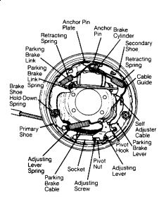

I have replaced all new rear brakes in my truck and the one side seems to lock up and drag going forward. When I spin the wheel while on the jack there is no resistence rolling backwards, but then there is when I spin it forward?Do I have the shoes backwards or something?

It is a possibility. I would suggest you take the other side off and look at it and compare the problem side.
Take a look at each part especially the steel bar at the top that goes between the shoes. Also check the e-brake components.

Here's a diagram...
https://www.2carpros.com/forum/automotive_pictures/188069_93rangershoes_1.jpg
