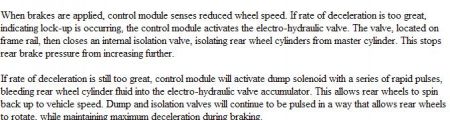

Hi there,
Thank you for the donation,
http://www.2carpros.com/forum/automotive_pictures/61395_1_70.jpg
Have a scan done as this may have a set fault code indicating a problem with this valve, start here.
