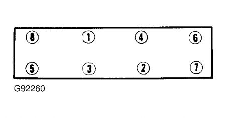

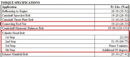

I would like to know the torque specifications on the connecting rod nuts and also the head bolts

What size motor? 2.9L, 3.5L etc?

Thank you for responding to answer youp question the ranger is a two wheel drive automatic with a 2.9l engine.

Be sure to tighten the head bolts in the sequence shown below..
