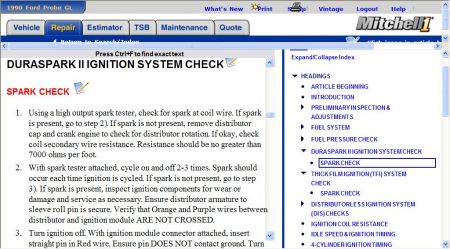

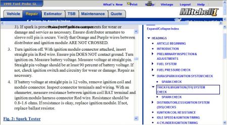

Do below to check for spark
https://images.2carpros.com/forum/automotive_pictures/12900_ds1_1.jpg
https://images.2carpros.com/forum/automotive_pictures/12900_ds2_1.jpg

no affence, but it does not have a dura spark II ignition system. I am familier with those. This has the ignition modual in the distributor on top of the stator . There is power to the coil when cranking & with the key on . I have tested the new coil & Distributor in another car even though they are new, and that car ran fine. The old one's tested bad by means of an ohms test , so that's why I replaced them.

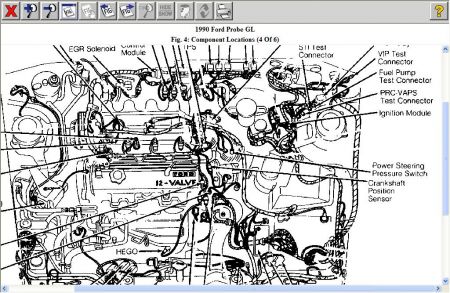

Last stop is the crankshaft positioning sensor located below
https://images.2carpros.com/forum/automotive_pictures/12900_cps1_4.jpg
