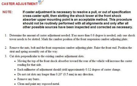

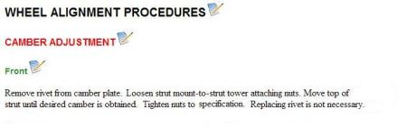

How to set camber and caster on the front end on a mustang 2003 mach 1
Friday, October 2nd, 2009 AT 6:39 PM
BLUELIGHTNIN6
MECHANIC
16,542 POSTS
+1
Sunday, October 11th, 2009 AT 9:48 PM
