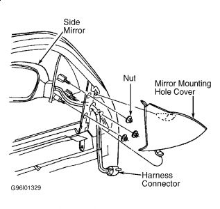

How do I remove an existing side mirror and install a new one that I just got? Thanks.

Disconnect negative battery cable. Remove door panel. Remove mirror mounting hole cover. See Fig. 3 . Disconnect mirror wiring harness connector. Remove mirror attaching nuts. Remove mirror assembly while guiding wiring and connector through hole in door. To install, reverse removal procedure. Tighten nuts to 108 INCH lbs. (12 N.m).
Fig. 3: Removing Side Mirror
