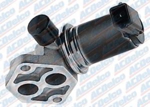

MY CAR JUST STARTED TO STALL AT IDEL, IT STARTS THEN WANTS TO STALL BUT WONT AT FIRST WILL IDEL AT ABOUT 500 RPM AND AFTER A FEW SEC. IT WILL TURN OFF?

Check the IAC(idle air control valve), it's bolted to the side of the TBI.
https://www.2carpros.com/forum/automotive_pictures/62217_IAC_8.jpg
https://www.2carpros.com/forum/automotive_pictures/62217_CRC_Throttle_Body_13.jpg
Clean throttle bore with this.
