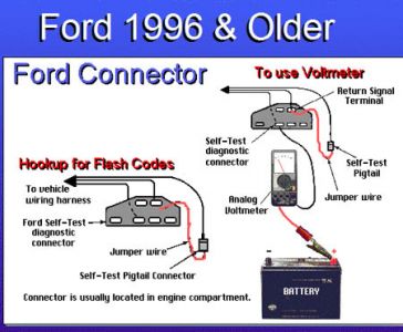

First thing you need to do is have the codes read, Autozone does it free, Post the results with the code number(s). Even if the service engine light is not on, there should be freeze frame data stored.
https://www.2carpros.com/forum/automotive_pictures/62217_Test_Connector_Pre96_4.jpg
Or do this and count the flashes...Count the flashes, a 22 will flash as 2 flashes then a short pause, then 2 flashes, if more than one code is stored, the pause will be longer. The codes will display three times and end with 11 or 111. Write them down and post here.

You have an OBDII connector? 95 should be OBD I style, and if the light flashed, there should be keep alive memory info stored. You need to test OBD I both KOER and KOEO.
