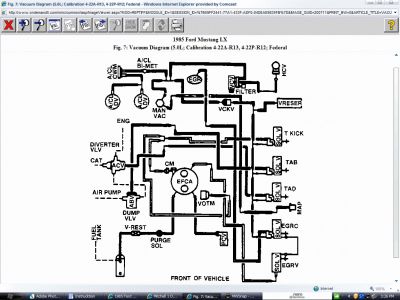

1985 Ford Mustang Vacumn hose routing
TOM L JONES
  • 1985 FORD MUSTANG
  • V8
  • 2WD
  • 176,000 MILES
I need diagram of vacumn hose routing for 5 liter V8, auto trans. Thanks
Friday, April 11th, 2008 AT 1:56 PM
MERLIN2021
  • 17,250 POSTS
There are four different vacuum routings used on Mustang 5.0, it depends what engine calibration code is on the drivers door, or valve cover...I posted all of em, you decide!
https://www.2carpros.com/forum/automotive_pictures/62217_Vac_lxa_1.jpg
https://www.2carpros.com/forum/automotive_pictures/62217_Vac_lxb_1.jpg
https://www.2carpros.com/forum/automotive_pictures/62217_Vac_lxc_1.jpg
https://www.2carpros.com/forum/automotive_pictures/62217_Vac_lxd_1.jpg
