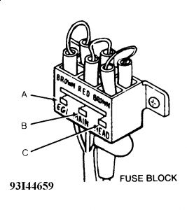

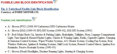

Hi there, Can you please identify which link is overheating? see pics. Mark (mhpautos)
https://images.2carpros.com/forum/automotive_pictures/61395_Graphic_115.jpg
https://images.2carpros.com/forum/automotive_pictures/61395_Noname_61.jpg
Apr 9, 2009 at 7:21 PM
BUDLEE
  • 6 POSTS
It's B the one marked main
Apr 9, 2009 at 7:38 PM
MHPAUTOS
  • 31,937 POSTS
OK,
so now we know what we are looking at, start pulling the fuses of the items listed in the text and check to see if the link is still hot. do this one at a time and give it a chance to heat up.
