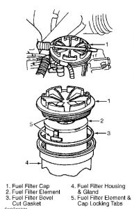

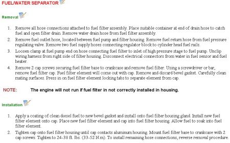

I am changing the fuel filter on my f350 international deisel truck and I have had many people tell me different things and just want to know the right way
