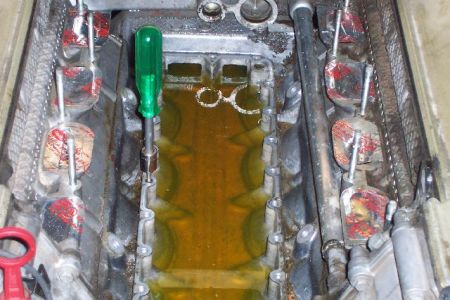

What is a valley pan. And how to replace it
Monday, November 2nd, 2009 AT 2:19 PM
MATHIASO
  • 1,209 POSTS
Valley pan is this:
https://www.2carpros.com/forum/automotive_pictures/46384_valley_pan_1.jpg

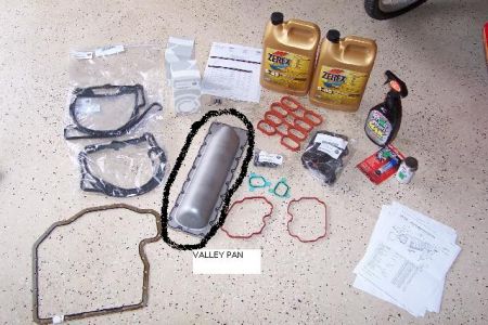

here is what you will need to get to it:
Valve cover gaskets (including 22 grommets)
Intake gaskets
Rear manifold gaskets (the blue-green things)
Intake rear gasket (and front, just in case)
Water pump O-rings, two small, two large.
Oil Separator Valve
Valley Pan, with integral sealing gasket
https://www.2carpros.com/forum/automotive_pictures/46384_valley_pan_gasket2_1.jpg
