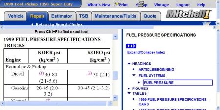

99 f250 4x4 super duty Fuel pressure cold only at about 32 psi dropping to about 28 psi running. Have cleaned injectors,replaced fp regulator,replaced fuel filter....could sensors be bad without a code.. any ideas....what should my pressure optimally be ....help

Hi bear65, Welcome to 2carpros and TY for the donation what should my pressure optimally be-See below
https://images.2carpros.com/forum/automotive_pictures/12900_f250_1.jpg

any ideas what might be causing the low pressure other than what I have tried
Feb 6, 2010 at 3:05 PM
  • 75,992 POSTS
Could be low voltage to the pump, intank pick-up sock or the fuel pump itself is weak

is there a specific test to check if fuel pump is weak
and how much voltage should there be at the pump
Feb 6, 2010 at 4:57 PM
  • 75,992 POSTS
If it doesn't meet the specs above by using a fuel pressure gauge. Also check if you have a low pressure pump in the tank and also an external one-The voltage should be 10volts and higher
