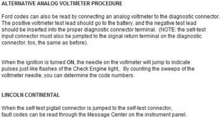

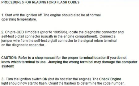

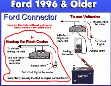

BRANDEN967
Thanks for the help. I'll try the vac line hunt tonight. I dont think its the trany screen because it does the idle issue regardless of in or out of gear. But the check engine light is on. How do you read it for that year.

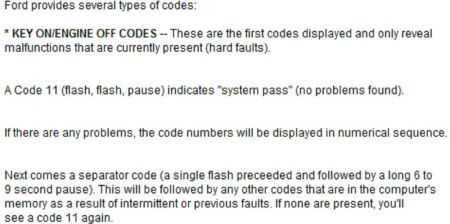

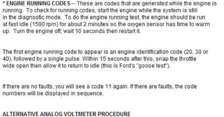

MERLIN2021
  • 17,250 POSTS
https://www.2carpros.com/forum/automotive_pictures/62217_Codes1_1.jpg
https://www.2carpros.com/forum/automotive_pictures/62217_codes2_1.jpg
https://www.2carpros.com/forum/automotive_pictures/62217_codes3_1.jpg
https://www.2carpros.com/forum/automotive_pictures/62217_codes4_1.jpg
https://www.2carpros.com/forum/automotive_pictures/62217_connector2_1.jpg

BRANDEN967
Well Im stumped yet again. I went through all of the tests and I still can't figure it out. I sprayed all of the vacuum lines, clamped the brake booster hose and a couple of other little things but still can't figure it out.
I read the check engine codes and on the engine running test I got code # 998 which I believe was a hard fault. Whatever that means. During the engine off test it kept giving me code #223 which I believe just comes up because the engine was off.

MERLIN2021
  • 17,250 POSTS
223. Loss of Dual Plug Ignition Control
998. Fuel management mode problem
