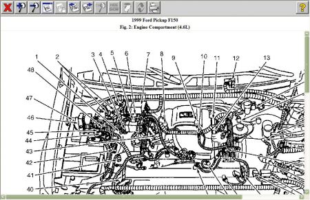

I have a 99 f150 w/ 4.6 246000 mi when idleing the truck seems to be going to die but accelerates fine and cruises good. Replaced plugs and wires which were very bad but still rough

IACV
Find item no.9 take it out and clean it make sure it has good connection.
