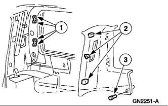

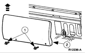

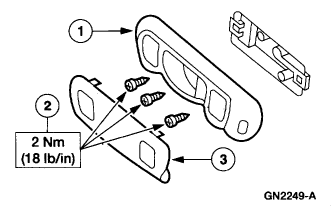

Back window leaks. I was told that the cargo light would solve problem it appears to me that the light has nothing to do with sealing the window. Will changing the light help me? Also, do I need to remove the head liner to get to the clip on the wire or is mine just stuck?

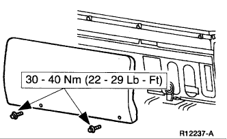

Well, I attached how to remove and replace the back window. Hope that helps. Also, it appears that this may be a common problem as they have a technical service bulletin on it. I have provided that also.
Removal:
https://www.2carpros.com/forum/automotive_pictures/248015_1_30.gif
Remove the rear seat back.
1 Remove the bolts.
2 Lift up to remove the rear seat back.

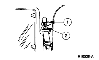

https://www.2carpros.com/forum/automotive_pictures/248015_2_38.gif
Remove the safety belt guide bolt.
1 Lift the cover.
2 Remove the bolt

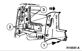

https://www.2carpros.com/forum/automotive_pictures/248015_3_28.gif
Remove the roof side rear trim panel.
1 Remove the pin-type retainers.
2 Pry and release the clips.
3 Slide the roof side trim panel out of the retainers and remove the roof side trim panel.

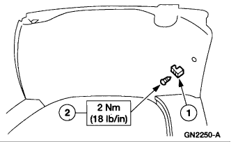

https://www.2carpros.com/forum/automotive_pictures/248015_4_21.gif
Remove the coat hooks.
1 Remove the two screws.
2 Remove the two coat hooks.

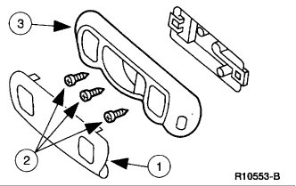

https://www.2carpros.com/forum/automotive_pictures/248015_5_15.gif
Remove the dome lamp.
1 Carefully pry the lens out of the dome lamp.
2 Remove the dome lamp screws.
3 Remove the dome lamp.

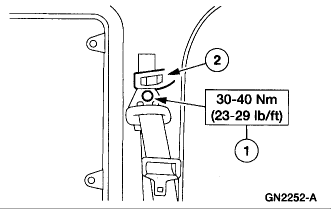

Install the safety belt guide bolt.
1 Install the bolt.
2 Install the cover.
