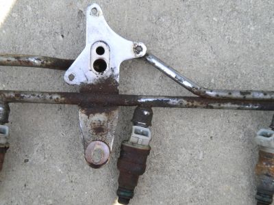

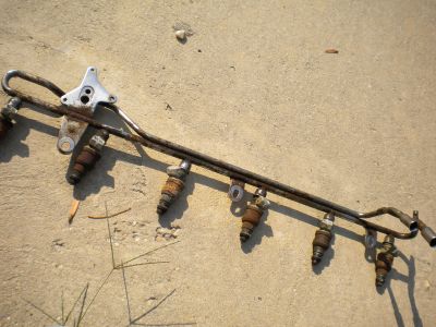

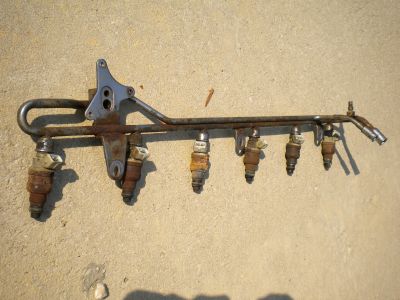

Its about 32 pounds the fuel rail is so rusty i just would feel safer replacing it,also the regulator had rust comeing out of it

You don't have enough fuel pressure.
Key On Engine Off 50 - 60 psi
Key On Engine Running 45 - 60 psi
