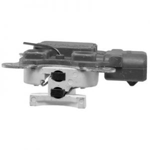

That was a good idea. Now, are you able to replace the regulator on that year?
Monday, July 26th, 2010 AT 1:14 AM
DAVID W. PADGET
  • 11 POSTS
I have been told the voltage regulator is in the alternaor and doesnt have an external regulator
Monday, July 26th, 2010 AT 4:46 PM
  • 110,192 POSTS
It could have an internal or external. Regardless, both are replaceable. The "internal one" is mounted to the outside of the alt housing. Here is a picture of it.
https://www.2carpros.com/forum/automotive_pictures/249084_a_5.jpg
Since the alt is new, I would say it is good, but one can never tell.
