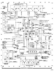

Yes, there is no fuse for the Wipers in the fuse panel drivers side under the dash. Check every fuse there, all good. Chilton's shows power coming from "S306" It is a splice off something, but can find no reference as to what. God, it can be this hard, there must be a power distribution point somewhere or a fusible link. But 8 hours of chasing and nothing.
Tonight, if I cannot find the point of origin for the power, I will isolate the circuit and just rewire it. But I just know there is a fuse somewhere.

I just looked through 4 different schematics and can't find it either. Did you check under the hood in the power distribution box? As far as the fuse box in the truck, everything is listed except wipers.

I found it. Fuse #17. The power wire is blue with a red tracer. Let me know if you find it. Here is a copy of the schematic. However, it will most likely be too small for you to see.
https://www.2carpros.com/forum/automotive_pictures/249084_5_68.jpg
Let me know what you find.
NOTE: From what I can tell, it also powers the radio, lights... Ground is through the wiper motor and the washer seems to have a wire to ground.

Yes, I believe that was correct. My fuse panel is no longer labeled, but as I peeled back the wiring harness, I found that the lead went to a good fuse... So got out the VOM and checked for voltage at the wiper. 12 volts. No worky. Went to the washer pump... 12 volts but no worky... Yep, went and bought them both, replaced them and bingo... All was well.
