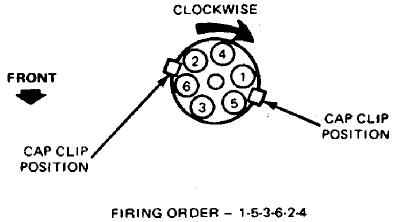

I GOT A FORD F-150 1985, STRAIGHT 6, I HAD TO TAKE THE DISTRIBUTOR OFF, NOW I CAN GET THE PLUG WIRES RIGHT FOR FIRING. CAN ANYONE TELL ME OR SHOW ME A DIAGRAM? THANK YOU.

Location On Distributor And Firing Order
https://www.2carpros.com/forum/automotive_pictures/12900_fo_15.gif

THANK YOU MUCH NOW ALL I HAVE TO DO IS FIND OUT WITCH WIRE IS NUMBER 1, ANY IDEAS?

Cylinder Numbering And Distributor Location
https://www.2carpros.com/forum/automotive_pictures/12900_fo_16.gif
