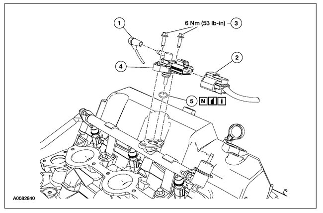

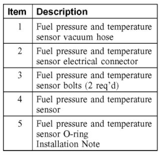

Shakes or wobbles problem. My check engine soon light has come on and the diagnostic read p0193. That code is a faulty fuel rail pressure sensor. If possible could you tell/show me where that sensor is located? Times are hard and I cannot afford for Ford to replace this sensor at a $400.00 price. I am no mechanic but I am handy unless you say that I should not even attempt such a task. Thanks. R. Torres
Tuesday, September 21st, 2010 AT 2:35 PM
17 Replies
KEN L
  • MASTER CERTIFIED MECHANIC
  • 55,090 POSTS
Yes you can change this sensor yourself in about 20 minutes. A small amount of fuel with be present during the job so have shop towels ready. Here is a diagram (Below) of the job being done. The part on Amazon for $36.00 - Motorcraft

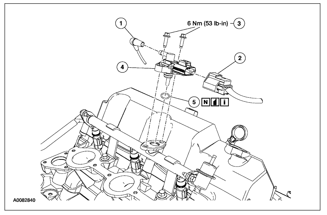

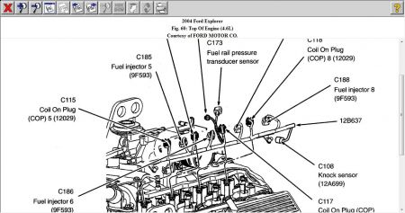

Having problems locating the fuel rail pressure sensor. I have the part, now I don't know how to get to it to change it. Fail code 0193.
Wednesday, November 29th, 2017 AT 3:01 PM (Merged)
  • 75,992 POSTS
Its located top rear of engine

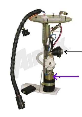

Hello, could someone tell me where a Fuel Pressure Regulator is for a 1999 Ford Explorer. It is a 4.0L V6 MFI OHV 4 Door Model. Im not sure if it is on the Fuel rail or part of the fuel pump assembly. I heard ford changed them on this model so im hoping someone could tell me for sure.
Thanks
FIXITMR
  • 9,990 POSTS
Try this. http://www.justanswer.com/ford/0zapi-fuel-pressure-regulator-99-explorer-4-0.html
RMOORE09
  • 132 POSTS
Thanks, but unfortuanely this is for a SOHC engine. I need a OHV one.
-1
FIXITMR
  • 9,990 POSTS
Black arrow.
