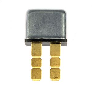

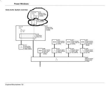

None of my power windows work. There is no power to the drivers side control. There is no listing for power windows in the fuse box.

Hello 8ballsgone Either the circuit breaker or the fuse is defective. look in the battery junction box for the fuse(F1.6) it is a 60Amp.
The circuit breaker is between the (BJB) and the central junction box(CJB) circuit breaker look like this:
(I'm sending the diagram to your email)
