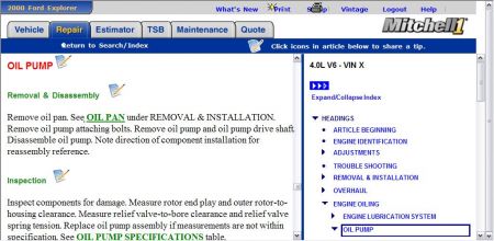

Where is the oil pump on a 2000 ford explorer with a v6 4.0 sohc

Its inside the crankcase see below for removal of oil pump
