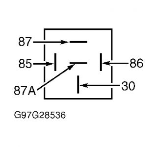

My door locks won't work in the front only in the back. I can lock and unlock them from here. I also can unlock them from front passnger side. And they keypad will unlock them but not lock them. Also my remote only works to unlock the doors. I cannot lock them with it. I have looked at the fuses and they are good. Where or what else can I do?

Okay. I have done some research (my head is killing me). I'm with you when it comes to computers, modules.
There are two things that can be causing this. One is a GEM relay (generic electronic module) which runs the locks, or a bad relay. Based on the several pages I read, I think you simply have a bad relay.
Locate auxiliary relay box #2, above the left rear wheel well and remove the lock relay. You need to check resistance between terminals 30 and 87A. If the resistance is more than 5 ohms, replace the relay. If not, apply battery voltage to terminal 86 and ground 85. Now read the resistance between number 87 and 30. If the resiistance is more than 5 ohms, replace the relay. If all tests are passed, we need to move on to the GEM.
Here is a picture of the relay to help you identify pin numbers. Let me know if this helps.

Sorry, I hit submit rather than upload. Here is the picture.
https://www.2carpros.com/forum/automotive_pictures/249084_5_25.jpg
Let me know what you find.

Okay guys, Sorry I took so long getting back to you. Vehicle hasn't stopped. I tessted both relays in the back where you said and both of them had 0 resistence. I guess we go on to the next step.
Remember that the lockbuttons will unlock only and the one in the rear will do both. Also the door ajar light stays on and am not sure we discussed this or if it has anything to do with the problem at hand. Good Luck and Thanks
