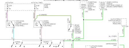

OK I have a problem so here it is: I don't have brake lights when I press on the brakes, but when I turn on my lights I have brake lights, I am not sure if I need a new bulb, fuse, or if its a short please help, and all of my other lights work just fine its only my brake lights

I'd have to check voltage to and from the brake switch. The lite green wire with red tracer is voltage to brake switch, hot all the time, when brake switch is activated, the lite green wire carries voltage to brake lites.
https://www.2carpros.com/forum/automotive_pictures/170934_94_ford_explorer_brake_lites_1.jpg
