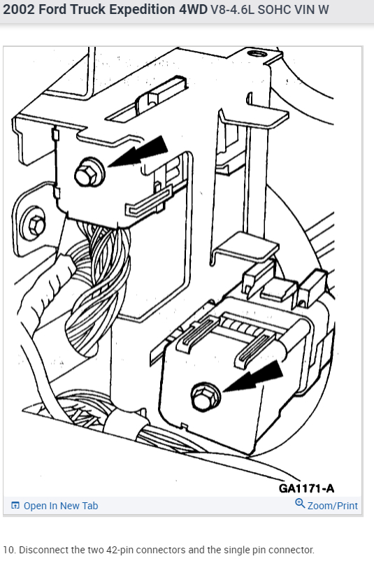

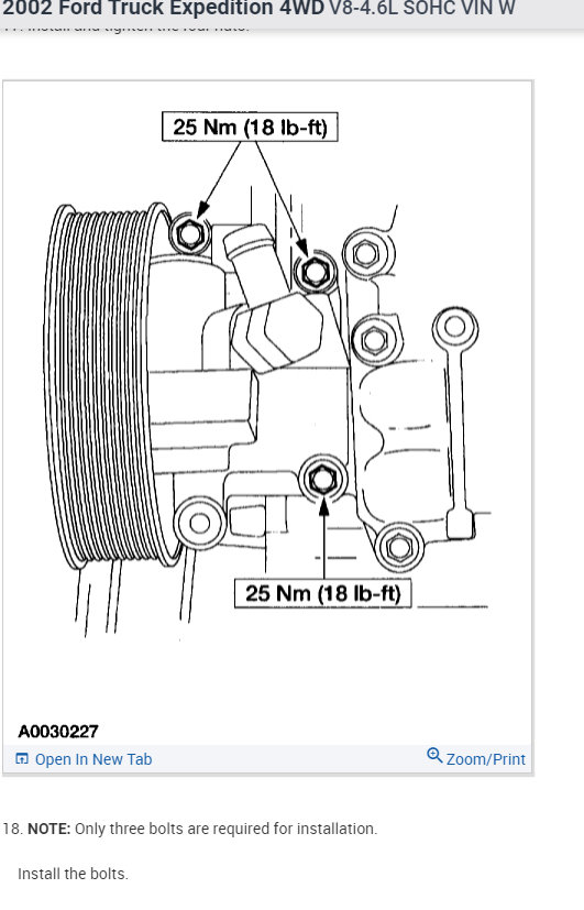

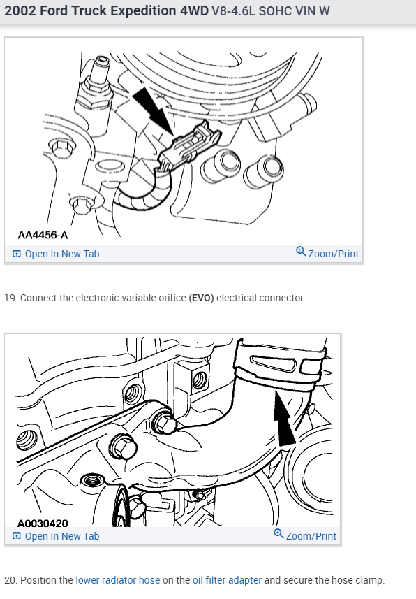

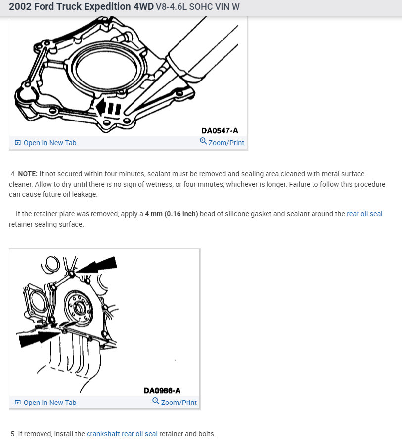

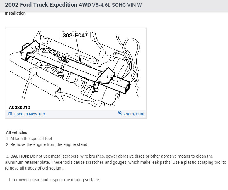

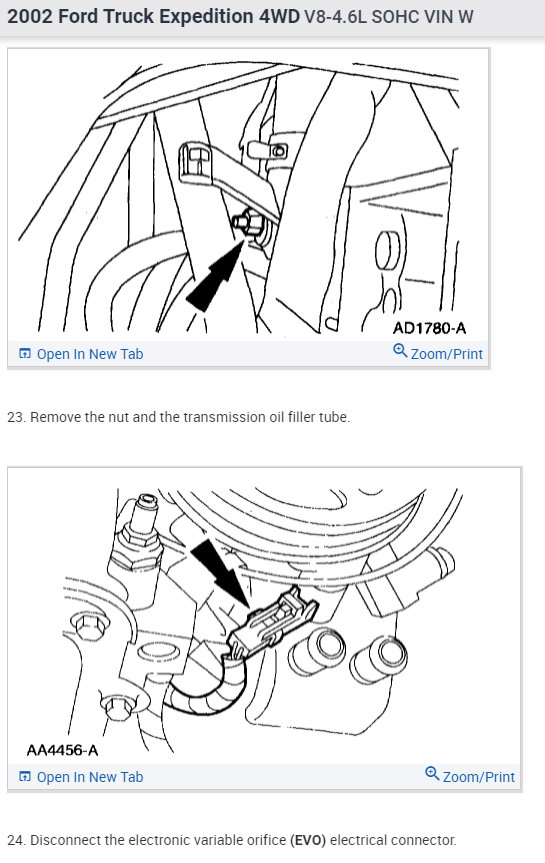

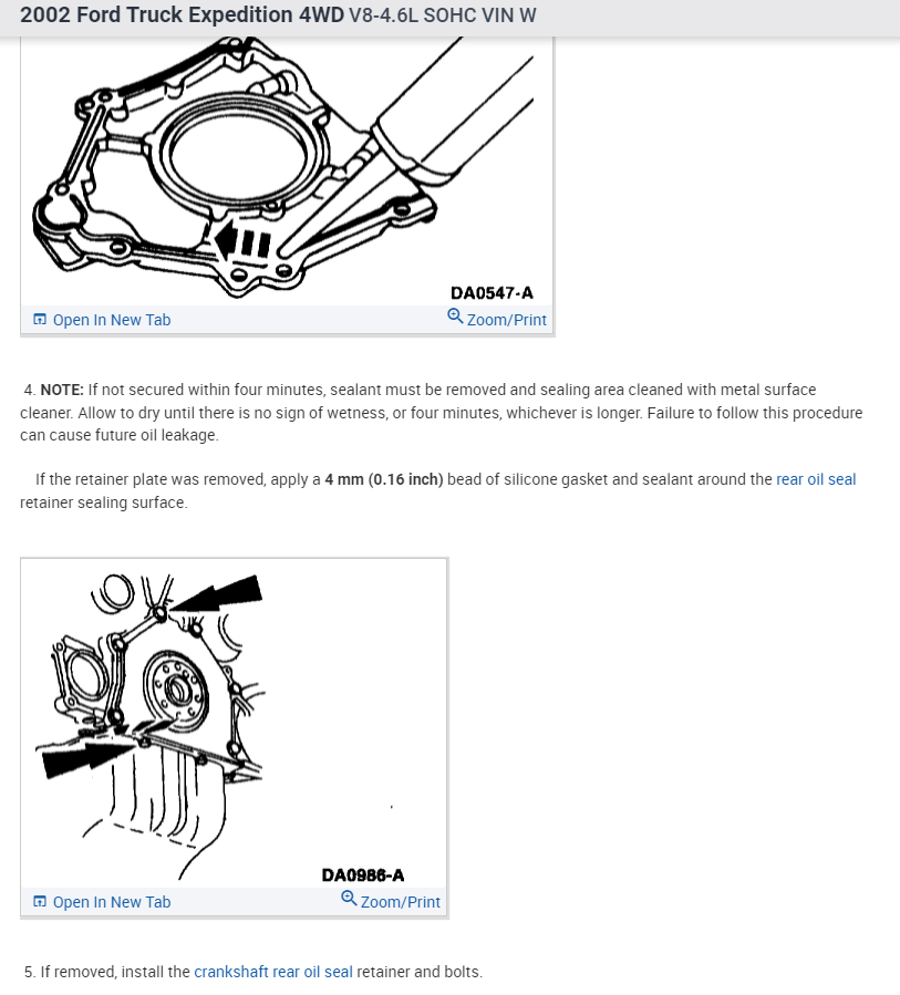

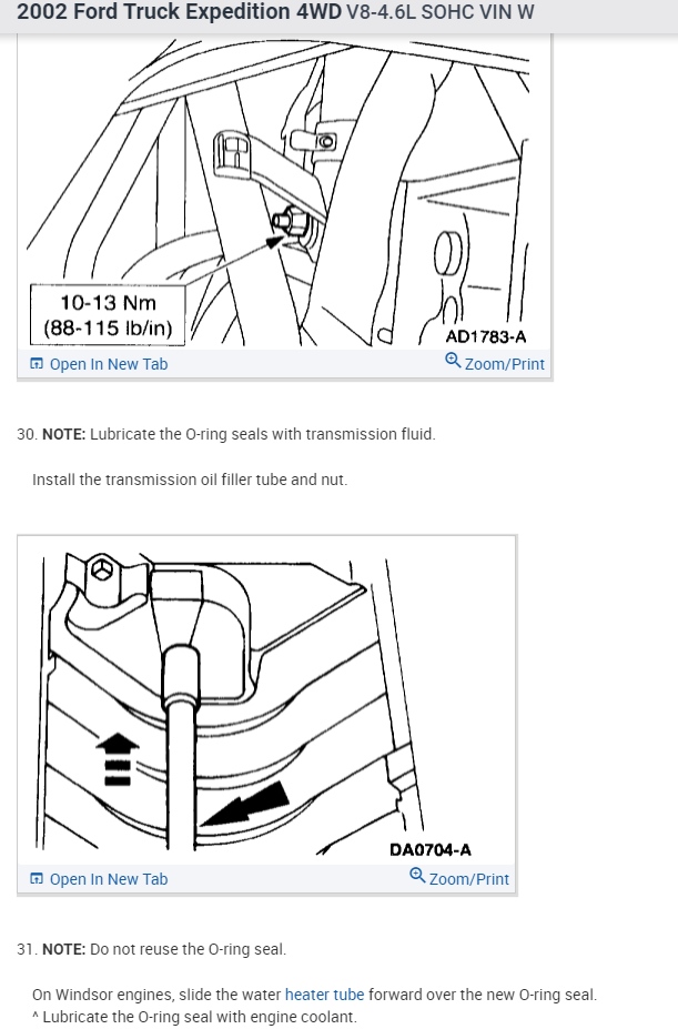

Will a 98 4.5 motor interchange with a 2002 4.5 motor
Wednesday, April 1st, 2009 AT 8:57 AM
SQM
  • 6,383 POSTS

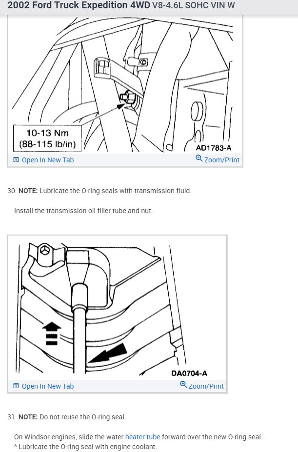

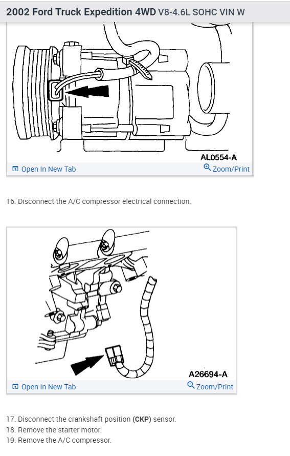

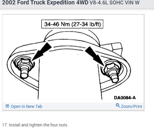

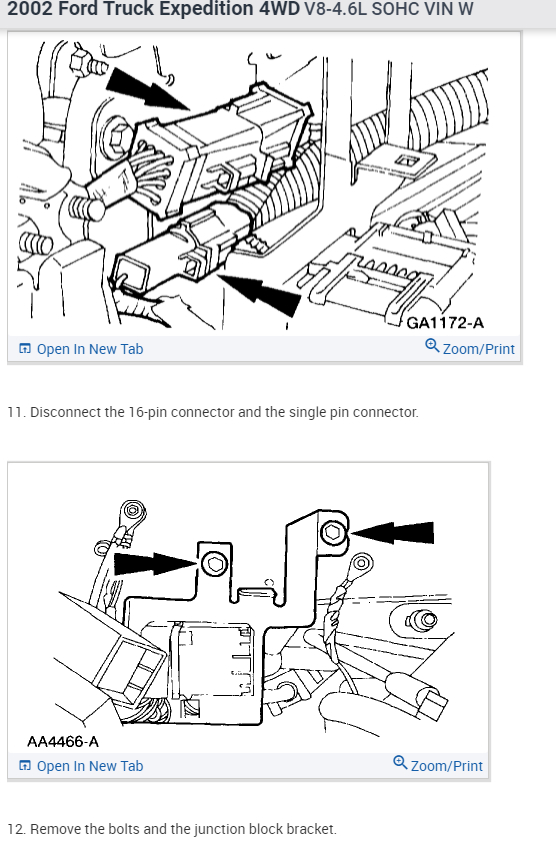

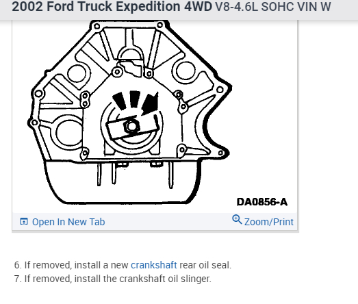

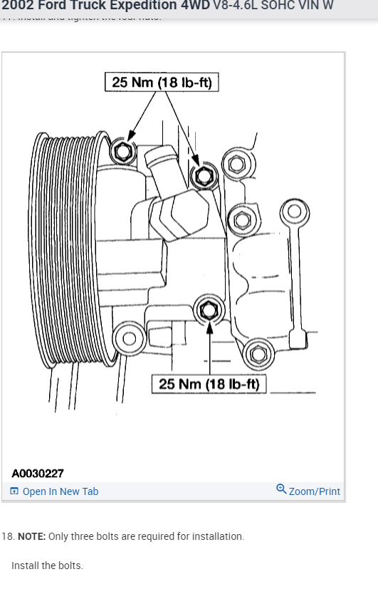

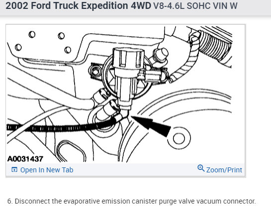

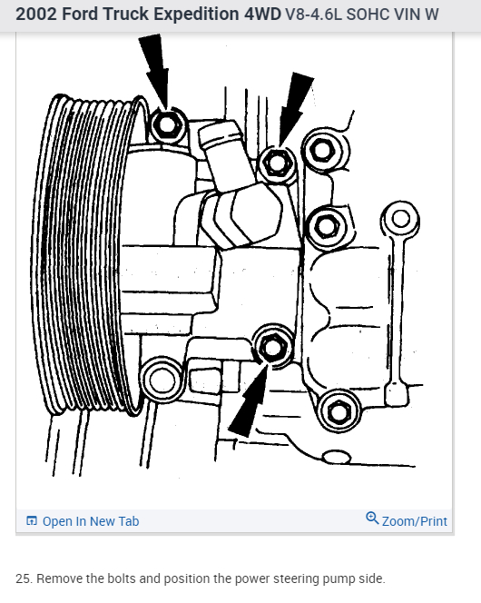

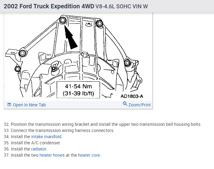

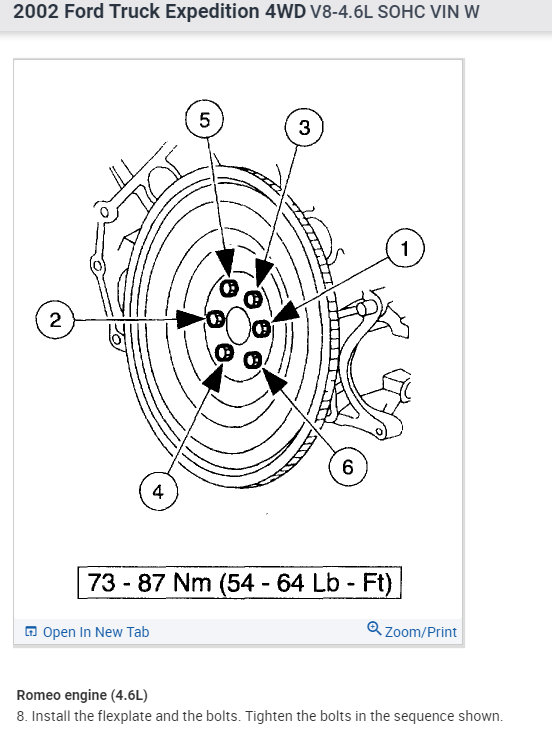

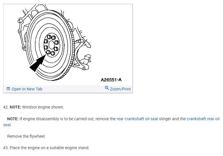

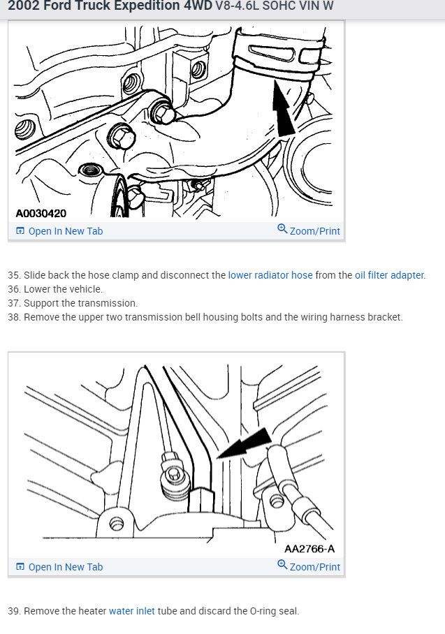

This vehicle uses a 4.6L V8, not a 4.5L.
The 1998 4.6L V8 is not interchangeable for a 2002 4.6L V8. They have different VIN code.
The 2001 and 2002 uses the same engine.
Here is a helpful tutorial on engine replacement:
https://youtu.be/zy1CozLgWUQ

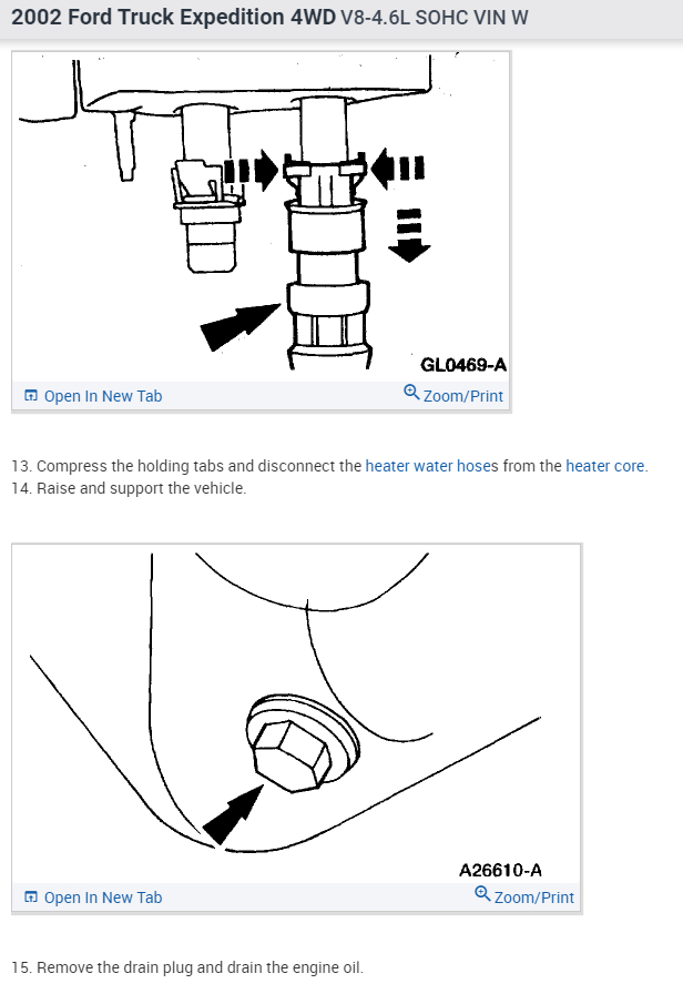

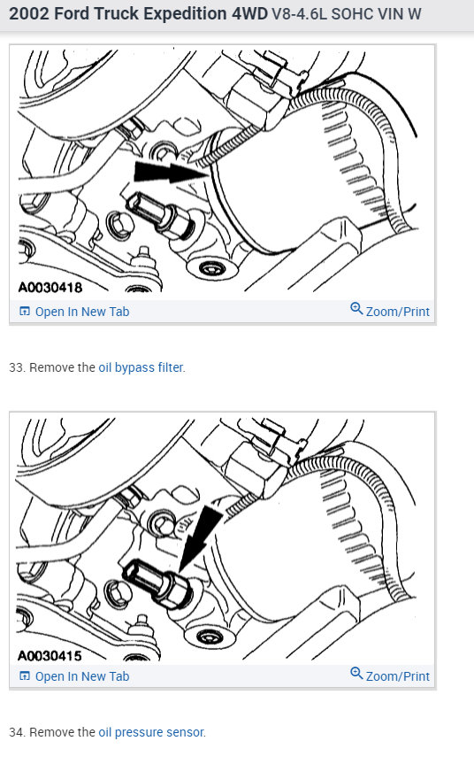

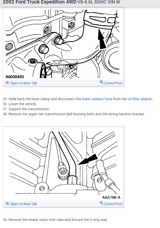

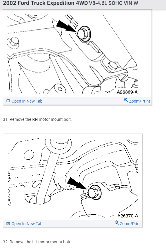

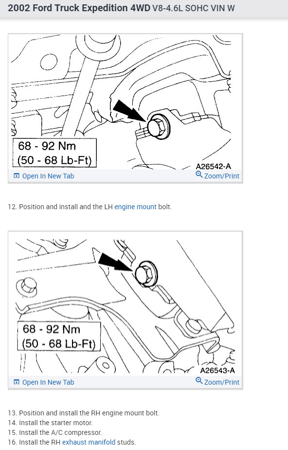

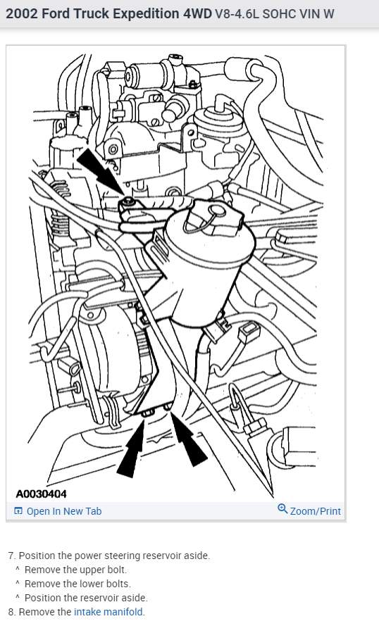

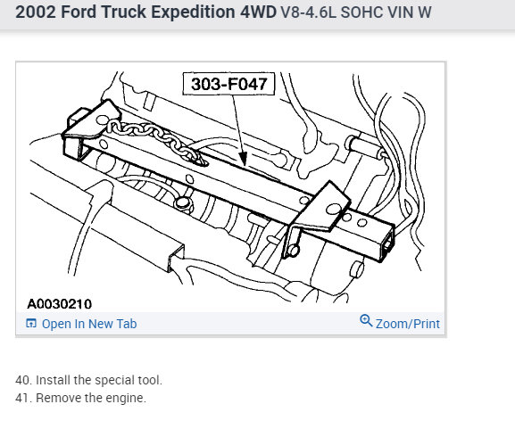

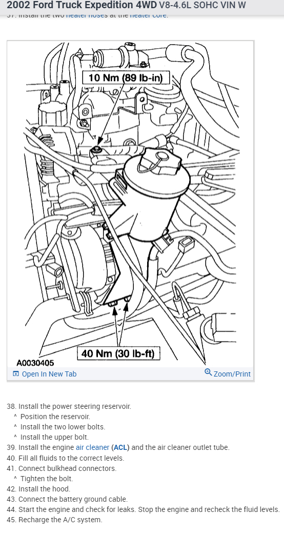

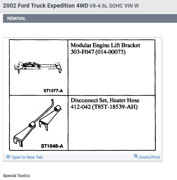

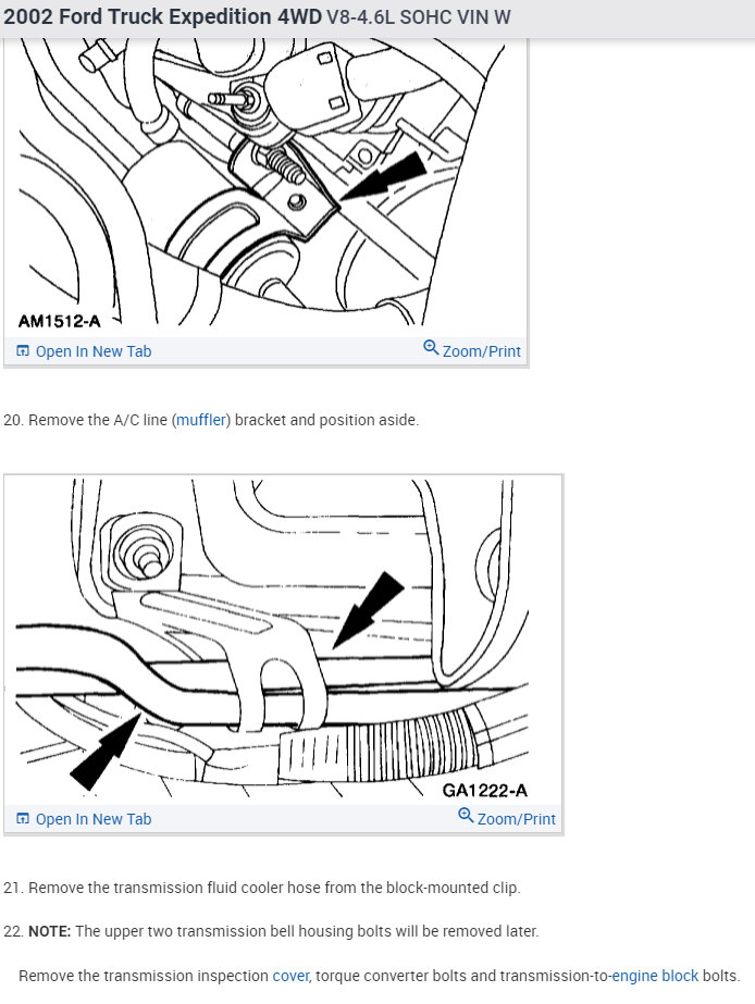

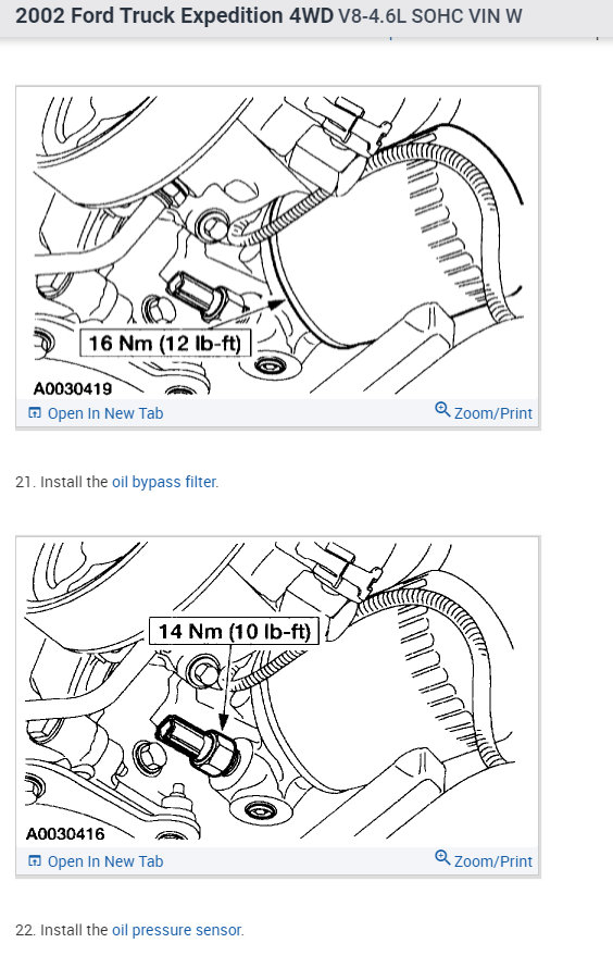

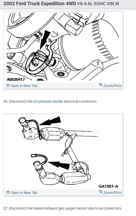

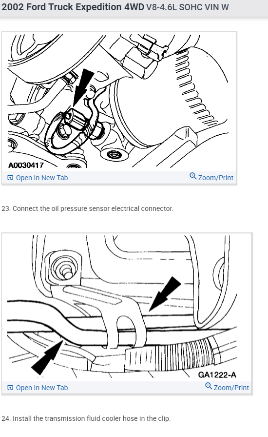

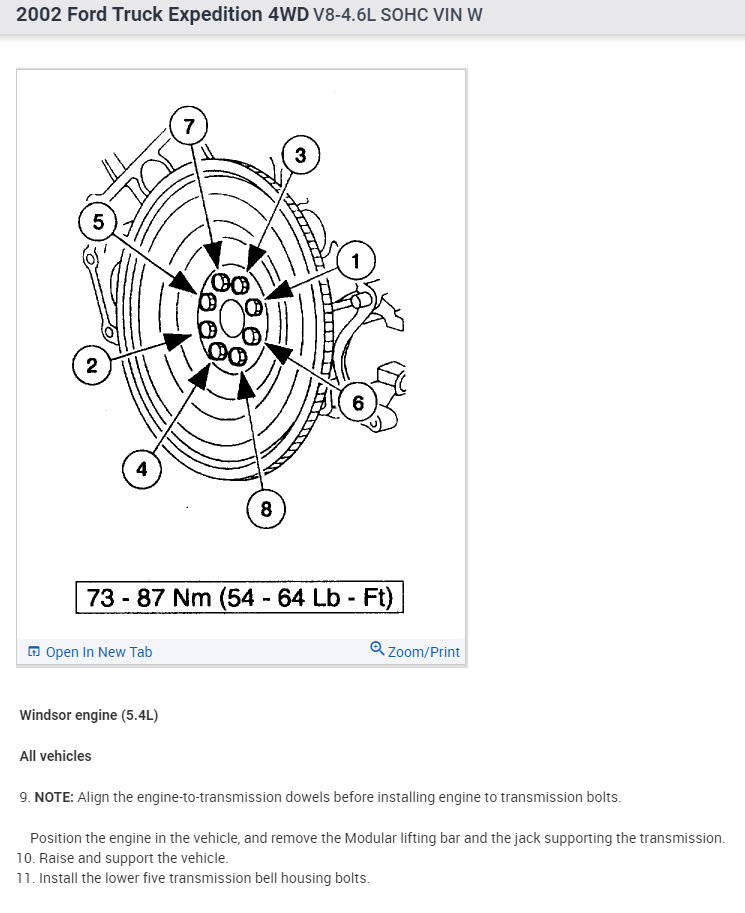

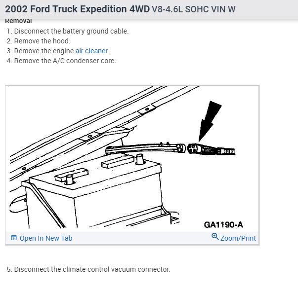

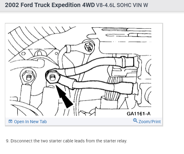

I have attached the engine replacement instructions below.
