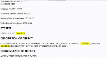

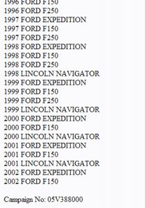

What I see is what's left of the truck, the fuel filter could be in the right spot, but most ford filters are near the rear tire, connected with plastic hoses and locking clips, a fire would most surely destroy yhe fuel line. I am not sure but the 2000 Expidition may have caught fire by itself, the cruise deactivation switches, on some of these I believe were defective and known to cause fires....Here's the recall info...
http://www.2carpros.com/forum/automotive_pictures/62217_VSC_Recallb_1.jpg
http://www.2carpros.com/forum/automotive_pictures/62217_VSC_Recalla_1.jpg
3,800,000 vehicles where affected by this recall. Good luck! By the way, the vehicles did not have to be on or running to catch fire...
