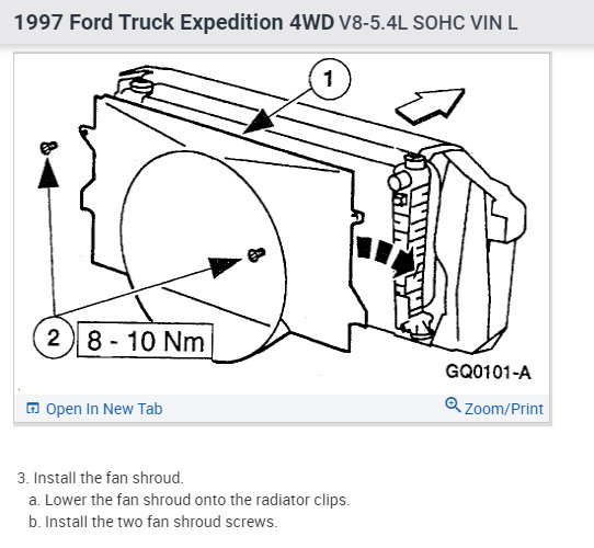

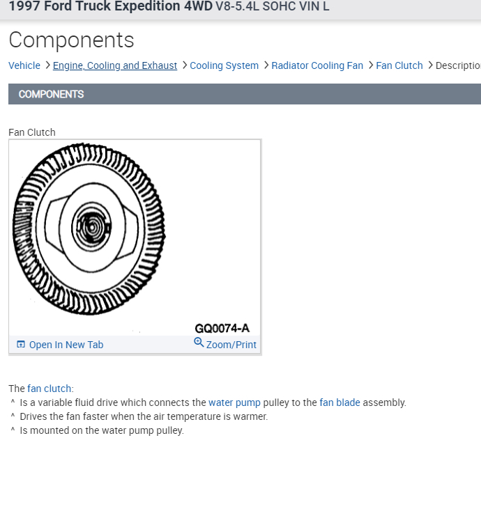

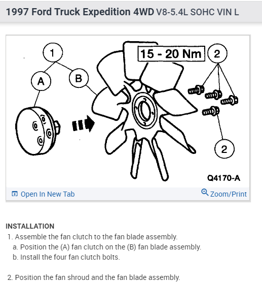

The vehicle temp gauge rises when I am sitting still like at a light but when I begin to drive the temp gauge comes down some and when I stopped to check the fluids and the oil was low but the oil or check engine light never came on. What is wrong with the vehicle
Saturday, June 27th, 2009 AT 6:12 PM
SQM
  • 6,383 POSTS

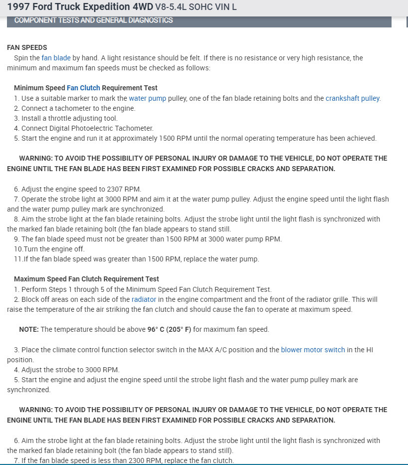

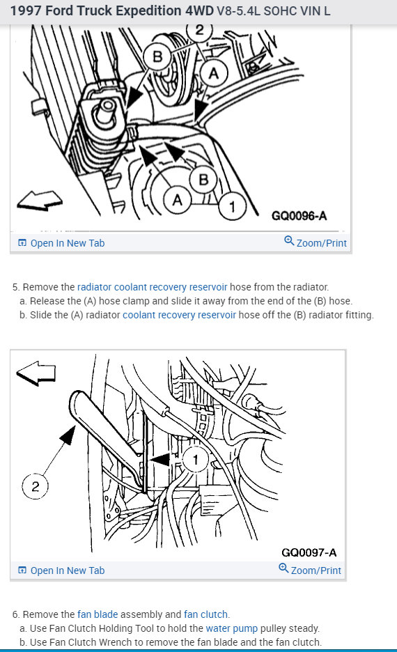

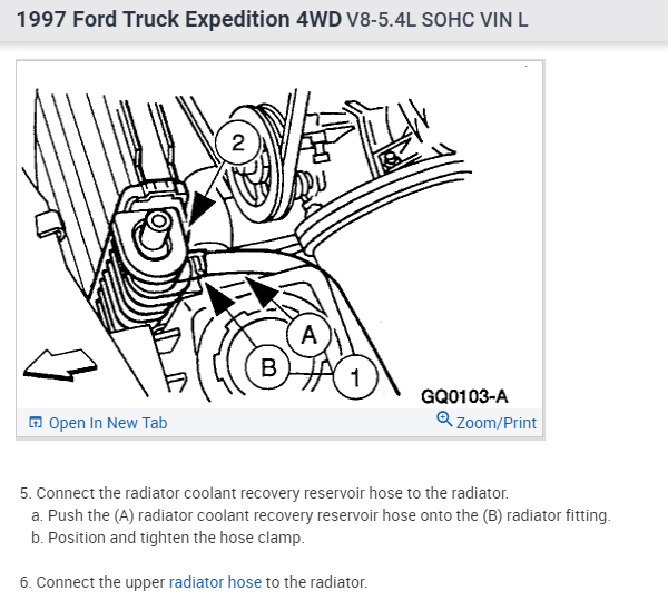

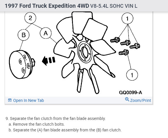

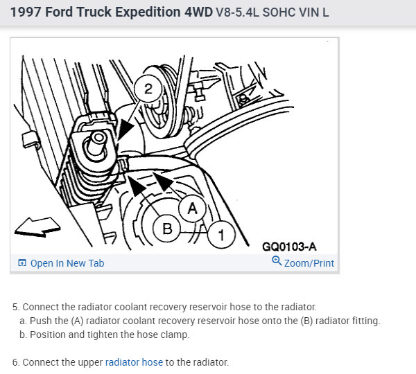

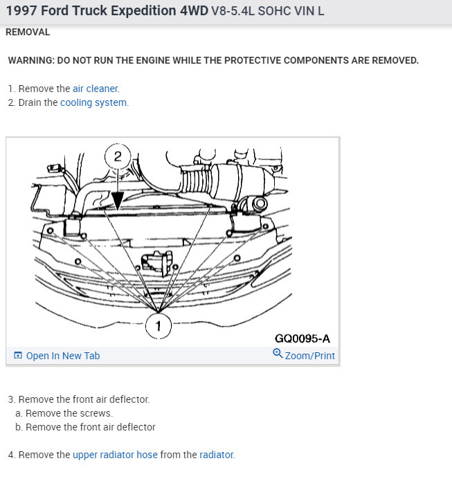

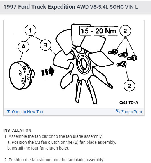

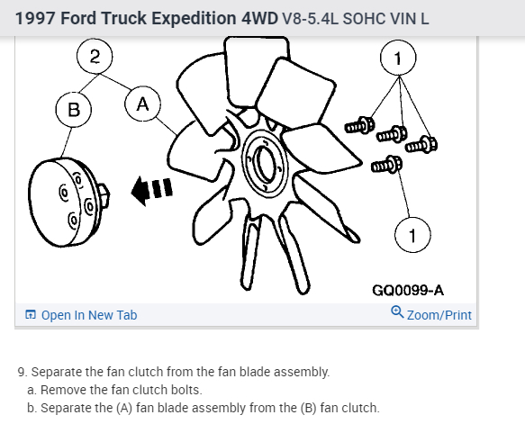

It sounds like you might have an inoperative cooling fan possibly due to a faulty fan clutch.
Usually when the cooling fan does not operate the engine will overheat when the vehicle is stationary, as there is little to no air flow through the radiator. But as the vehicle starts to move, so does air flow through the radiator. This brings down the temperature.
https://www.2carpros.com/articles/fan-clutch-symptoms

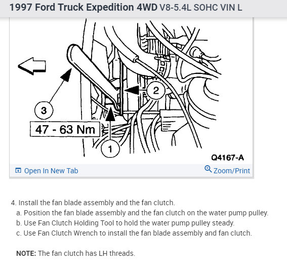

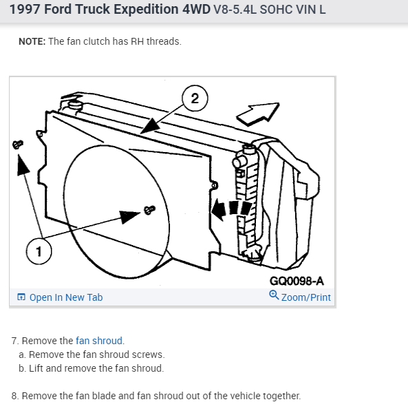

In order to replace the fan clutch you will have to use a fan clutch remover tool. Those tools can be rented from your local auto parts store.
https://www.2carpros.com/articles/fan-clutch-removal
