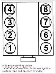

What is the firing order for this vehicle?

I'm not sure about the litre size of your engine. Check out the diagrams (Below). Please let us know if you need anything else to get the problem fixed.
