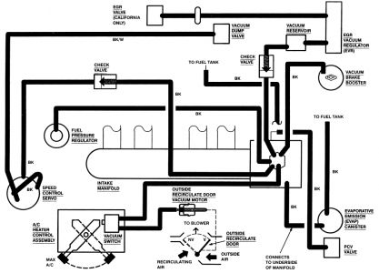

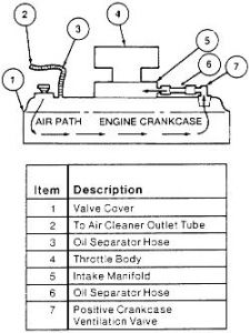

I have a 1995 ford escort LX with 140,000 1.9L I am not very knowledgeable when it comes to identification of parts. I need to replace the hose that runs from the pcv valve to I think the intake? I would like to order the original part but not sure on what the exact name for it is. Also when I make a right turn I heard like a rubbing noise could this be my cv joint. I just had the tierod replaced on the drivers side any help would be greatly appreciated. :Oops:

Well, I call it a PCV valve hose. Some people call it a Oil Separator hose.
http://www.2carpros.com/forum/automotive_pictures/103836_escort_1.jpg
http://www.2carpros.com/forum/automotive_pictures/103836_escort_1_1.jpg
Escort Vacuum diagram

If you need a new PCV valve hose you may want to check the rubber grommet that the pcv valve sits in too. Usually it's worn and leaking.
