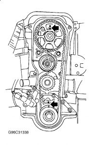

I have the belt off. I turned the cam till it looked like the valves were all closed. Should I put the belt back on (timed correctly of course) then give it a try? By the way, I am doing this by hand. I'm not cranking the motor over. I'm not sure what the original problem was. The guy told me that the timing belt needed changed and I stupidly took his word. I'm not out anything but I would like to get it running for a back up vehicle.
Thanks again.
Friday, December 14th, 2018 AT 9:35 AM
DOCFIXIT
  • 18,828 POSTS
Yes install Tbelt and turn by hand
https://www.2carpros.com/forum/automotive_pictures/198357_Graphic_386.jpg
