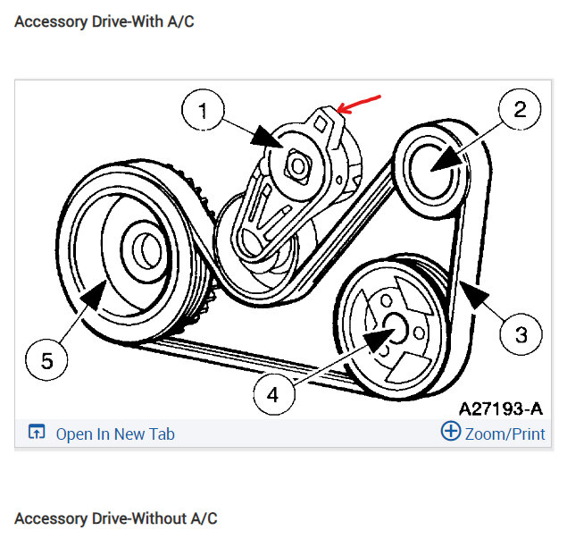

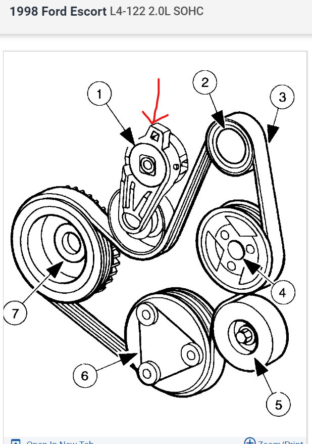

is there a spring release for the pulleys to install a alternator belt

There should be a belt tensionor on this model, just put a wrench on it and turn it away from the belt and it will loosen it.

Yes, use a 1/2 inch breaker bar or ratchet on the belt tension here is how in the images below. Check out the images (below). Let us know if you need anything else.
