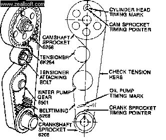

new belt new pump that left u with cam or crank
if they are turning all should be good and its their problem
if not u have a bigger problem ceased engine
https://www.2carpros.com/forum/automotive_pictures/99387_escort_1.jpg

It could have been an old timing belt in-stock for a long period of time and deteriorated on the shelf. Could have been a waterpump/idler pulley failure. More likely could have been installed improperly because the tension was not set properly. Hopefully they will check it out and do the right thing. If they say it's not their fault, be sure to get the broken belt and have another shop look at it -- second opinion.

They suspect the oil pump. They were checking a few thing and everything was turning fine. The oil light was flickering be4 the belt broke the 2nd time. So they think it was lacking oil pressure. They said the dropped the pan and check one of the crankshaft bearings to see if it was maybe lacking pressure do to a old wornout engine. When they looked at the bearing it only had normal wear. So the they put another timing belt on so they could start the car to do an oil pressure check. And there was no oil pressure. So they said it is almost definitly the oil pump. They also removed rocker arms to spin cam freely. They said it turn and then they could feel it catch a little, but once oil gets up there it should help that. They said this car the cam doesn't have any bearings. And they did all of this minus the oil pump free. Butr they want $475 to replace the oil pump. Any comment or cocerns or info would be appreciatted
