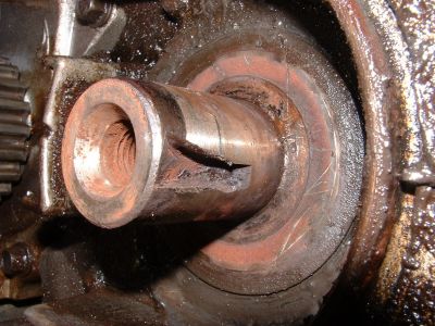

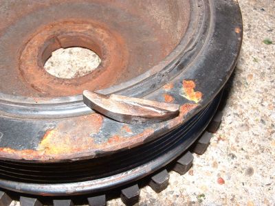

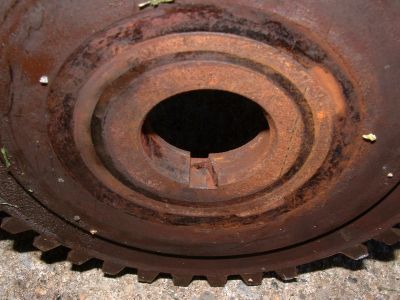

I'm pretty sure I've solved the problem. Can't find out for sure until tomorrow. MY harmonic balancer, the shear key was demolished. I noticed sometime ago that it was vibrating while the engine was running. Didn't think to much about it because the vr sensor was still lining up with the teeth on it. Well I just pulled it off and the first thing I noticed was a large build up of rust behind the bolt. Then I took it off and well yeah. Lets just say I'm lucky it was even spinning with the engine. Anyway I'll get a new one tomorrow, hopefuly get to put it on and I'll let you guys know.

That has to be what is wrong. The woodruff key had twisted making the timing off. The crankshaft is ruined tho along with the balancer it's self. The key hollowed out a huge section of the crankshaft and widened the space on the balancer. So all of that will have to be reaplaced. Luckily it's not to exspensive and I can do it my self. So I found my weekend project. After I get everything back together I'll post how the car is preforming. Thanks for all your help.

That was it. The car runs like brand new. Thanks for all of your input.
