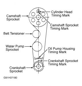

How do you line up pulleys for timing belt and were to find marks for them

Hi there ,
I hope that this helps.
Mark (mhpautos)
