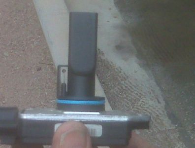

REDNEKWIZARD
  • 30 POSTS
Also check the Maf sensor, if you can cover the hole in the airbox and it smooths out then it will be your mass airflow sensor which unfortunately is about 245 dollars.
