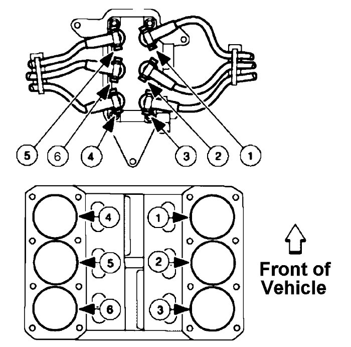

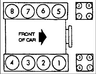

Ford E150 I want the diagram for the spark plugs. Thank you
Tuesday, January 22nd, 2019 AT 1:53 PM
9 Replies
D6SPAN
  • 58 POSTS
Hi Amber!
Here is the firing order for the cylinders and spark plugs. If you need a different diagram, please let me know and I will get it posted. I gave the V8 and 6 cylinders
V8 Firing Order: 1 3 7 2 6 5 4 8

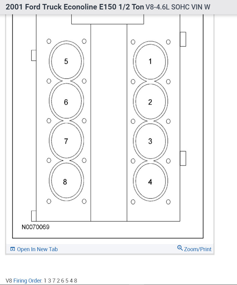

What is firing order for my van?
+3
Monday, August 24th, 2020 AT 6:40 PM (Merged)
BMRFIXIT
  • 19,053 POSTS
V8 E150 4.6L
https://www.2carpros.com/forum/automotive_pictures/99387_e150_46_1.jpg

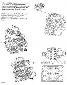

Wich is my no. 2 Cylinder on the engine?
Monday, August 24th, 2020 AT 6:41 PM (Merged)
JDL
  • 16,098 POSTS
https://www.2carpros.com/forum/automotive_pictures/170934_46_v8_1.jpg
4.6 v8

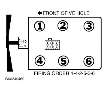

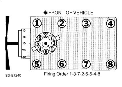

I was wondering what the firing order is for a ford e-250 3/4 ton van is? I replaced my wires set and plugs and it seems to start and run worse. So I want to make sure my wires are routed right. Thanks
+3
DAVE H
  • 13,384 POSTS
https://www.2carpros.com/forum/automotive_pictures/266999_e_1.jpg
https://www.2carpros.com/forum/automotive_pictures/266999_e2_1.jpg

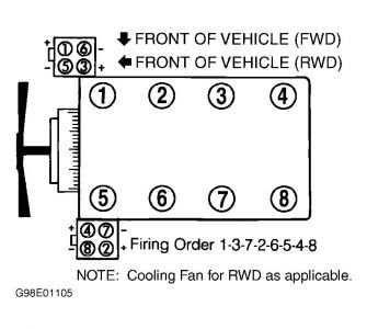

What is the firing order?
BMRFIXIT
  • 19,053 POSTS
https://www.2carpros.com/forum/automotive_pictures/99387_Graphic1_552.jpg
