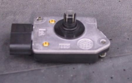

I have a van that has a miss. Starts up fine all the time but when I plug in the MAF Sensor I hear clicking sounds and it runs very rough. When I unlug the sensor the idle smooths out but has no power. WHen I remove the positive cable it resets the computer codes and then it will run fine for about 4o miles then the code must come back. I replavced the sensor. I had a local garage replace the injectors and they replaced them with used ones and the problem it still there. Where do the three wires go to from the sensor plug? This may help me trace them down. Thank you

Is a MAF Sensor and MAP Sensor two different parts?
Sunday, May 23rd, 2010 AT 7:22 AM
  • 75,992 POSTS
Its two different things one measure airflow and the other vacuum

Oh, where is the MAP Sensor located then? I have been replacing the MAF sensor only that uses a vacuum line. Maybe I am replacing the wrong part
Sunday, May 23rd, 2010 AT 7:34 AM
  • 75,992 POSTS
The MAP sensor is located at right side of firewall near AC/Heater blower motor.
Sunday, May 23rd, 2010 AT 7:39 AM
MCAVINEE
  • 69 POSTS
So it seems like I am purchasing the wrong part. I am a computer tech, but do have some limited mechanical knowledge.
I sholdl probably replace that sensor since I already replaced the sensor sitting on the air clearner assembly the one with the vacuum line running to it.
