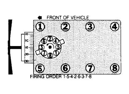

Can you please tell me the wiring order or send a diagram of the wires for this distributor please. Thank you

you didn't mention which engine this is for.. here is the 5.0L engine
https://images.2carpros.com/forum/automotive_pictures/261618_Graphic_372.jpg
