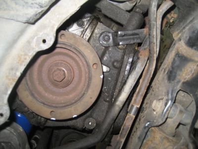

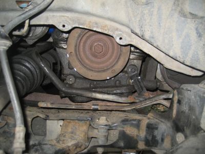

JOETOCOOL
  • 6 POSTS
https://www.2carpros.com/forum/automotive_pictures/546803_IMG_7184_2.jpg
https://www.2carpros.com/forum/automotive_pictures/546803_IMG_7185_1.jpg
Here is the trouble i have with the way it is to be set up i locked in the both cams when i go to the crank the marks do not match with TDC on number 1...
if you look at the balance r the 2 white marks on the left are the ones that are etch into the balance r the one on the right is the one that matches the tdc for number one plug.. there is no mark there i put it there just to show how it lines up

  • 110,192 POSTS
You mentioned that the cams are in place but the crank doesn't match up on #1. Is there a reason you can't loosten the belt and line it up?
Saturday, July 10th, 2010 AT 7:21 PM
JOETOCOOL
  • 6 POSTS
When I put the crank on the marks and the oil pain the car runs like crap it is like it is ruining on 2 cylinders the way it is set in the picture is the way the car runs good and has power I have tried it on both marks the picture is the way the car runs the best but gives me the p1381 code
+1
Saturday, July 10th, 2010 AT 9:02 PM
  • 110,192 POSTS
The only thing I can think of is this. If you stand on the passanger side looking at the cams, the one on the right (even when locked in place) can move Is it possible that you are moving it when installing the belt?
Saturday, July 10th, 2010 AT 10:22 PM
JOETOCOOL
  • 6 POSTS
Any thing is possible I real dont think so but if it did move how can I tell/put it to the right position?
Sunday, July 11th, 2010 AT 6:03 AM
  • 110,192 POSTS
Place the belt on that cam last so nothing moves.
