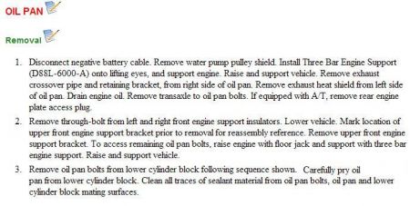

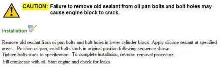

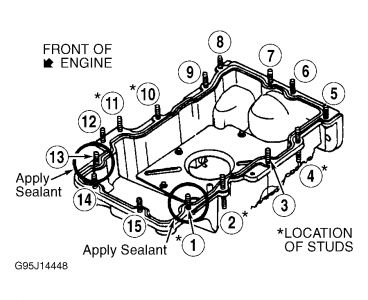

oil pan gasket is leaking! What to know how to change it! It looks like i have to pull the exhaust out to change it. Just want to know if i HAVE to do that.

https://images.2carpros.com/forum/automotive_pictures/261618_Noname_1192.jpg
https://images.2carpros.com/forum/automotive_pictures/261618_Noname2_350.jpg
https://images.2carpros.com/forum/automotive_pictures/261618_Graphic_222.jpg
