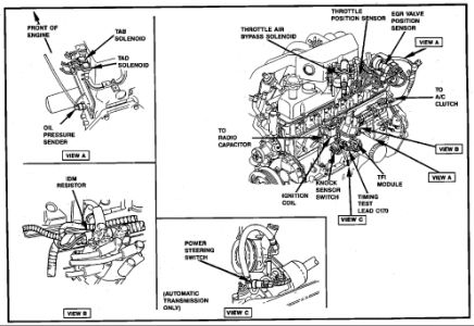

1990 Ford Bronco Check Oil Light On but oil is full.
TOO2GOOD
  • 1990 FORD BRONCO
  • 6 CYL
  • 2WD
  • 179,000 MILES
I have purchased an Oil Sensor, because the oil gauage jumps around when idling. But where to locate the sensor to replace is the "current problem">
Saturday, September 4th, 2010 AT 11:12 AM
  • 75,992 POSTS
Oil Pressure Sending Unit 4.9L On left side of engine, near oil filter.
