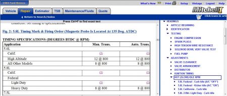

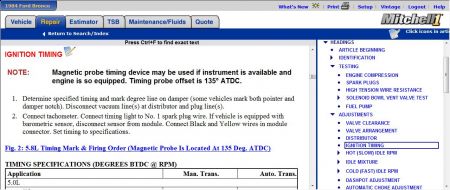

How do you reset the iginiton timing
Saturday, February 6th, 2010 AT 6:49 PM
  • 75,992 POSTS
https://www.2carpros.com/forum/automotive_pictures/12900_T1_3.jpg
https://www.2carpros.com/forum/automotive_pictures/12900_T2_3.jpg
Saturday, February 6th, 2010 AT 7:19 PM
