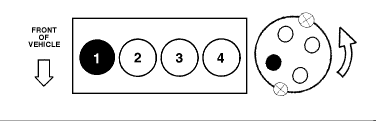

1997 FORD ASPIRE
Replaced rotor and distributor cap. Not sure if I have the plug wires and rotor on correct.
Thursday, February 4th, 2010 AT 1:42 PM
MECHANIC
75,992 POSTS
Check out the diagrams (Below). Let us know what happens and please upload pictures or videos of the problem. 1997 Ford Aspire L4-81 1.3L VIN H MFI
4-Cyl Firing Order: 1 3 4 2
