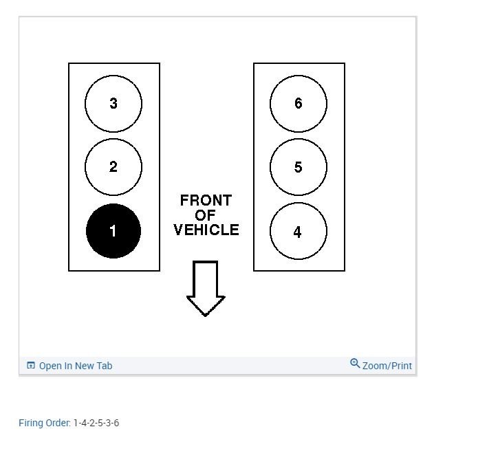

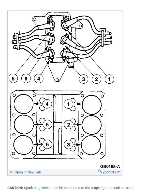

Hello, I have the van listed above E150, base model cargo van. I need to replace my spark plug wires. I made the rookie mistake of losing track of where they go. If anyone could give me a diagram or doodle that would be a blessing.
Feb 21, 2022 at 1:23 PM
Good afternoon,
I attached the diagrams for you of the firing order plus the location of the wires in the coil.
Feb 21, 2022 at 3:03 PM
VANDIVER
Hey Roy, I just wanted to say thank you. It helped a ton. I hope you have a great day!
