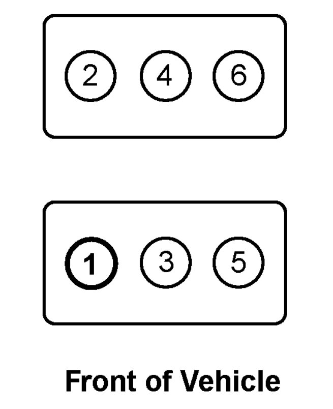

Spark plugs firing order?
Monday, October 21st, 2024 AT 8:21 PM
KEN L
MASTER CERTIFIED MECHANIC
55,130 POSTS
Sure here is the engine ignition system firing order.
Firing Order. 1-6-5-4-3-2
Check out the images (below). Let us know if you need anything else.
