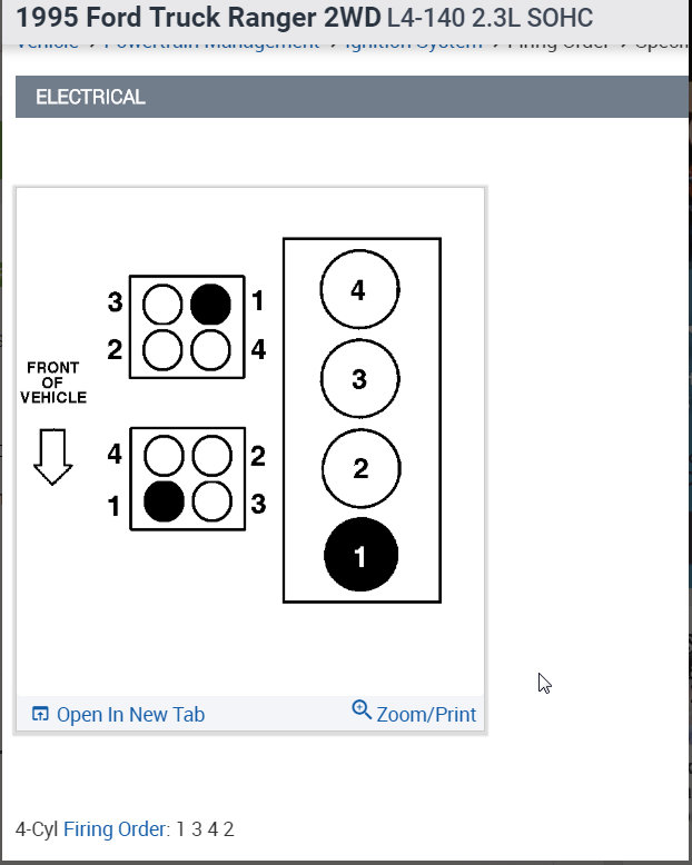

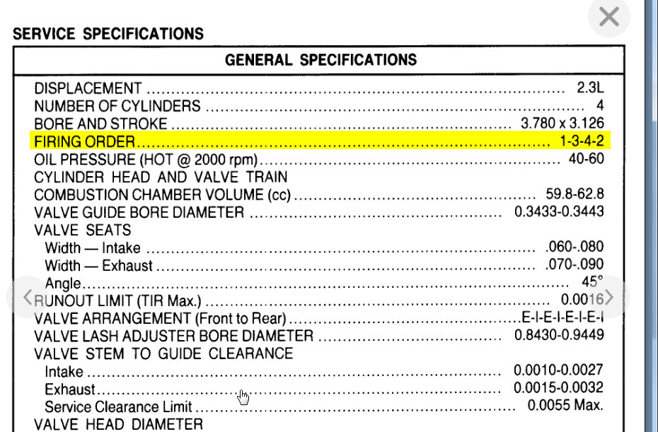

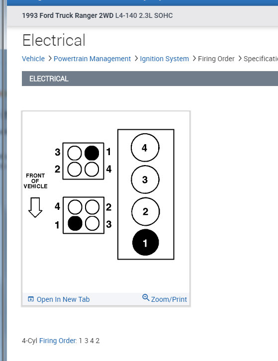

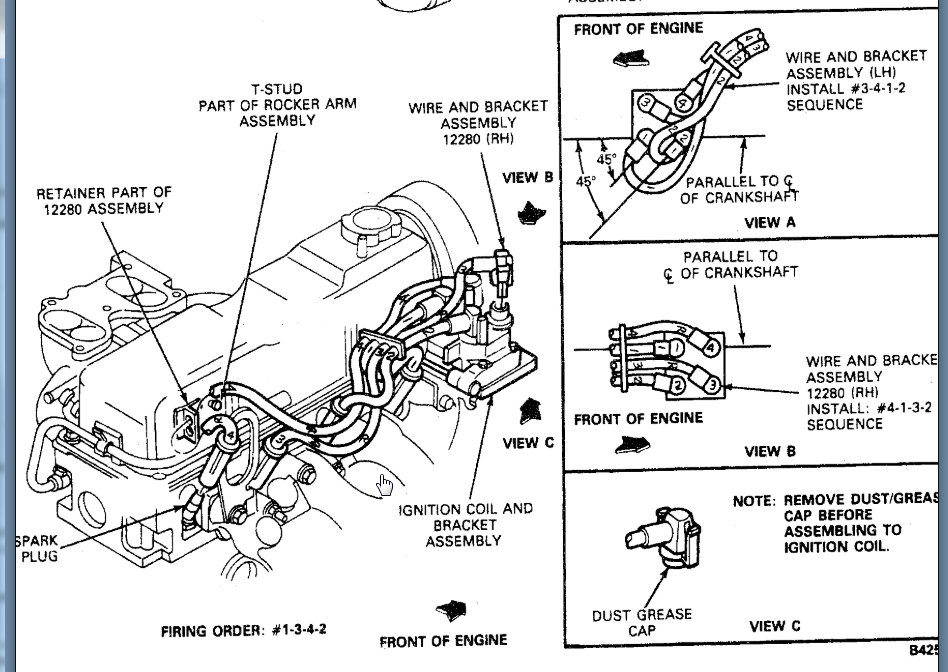

I need the firing order for a six cylinder 2.3 liter engine for the truck listed above.
Oct 17, 2020 at 6:45 AM
Please see the attachment for the firing order information for the 2.3L. Check out the diagrams (Below). Please let us know if you need anything else to get the problem fixed. Let us know if you need more info. Thanks

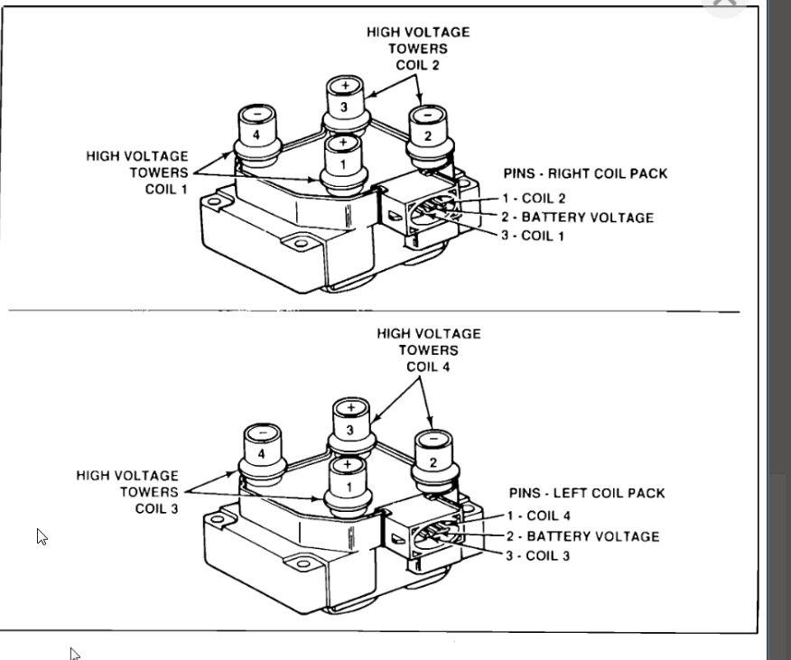

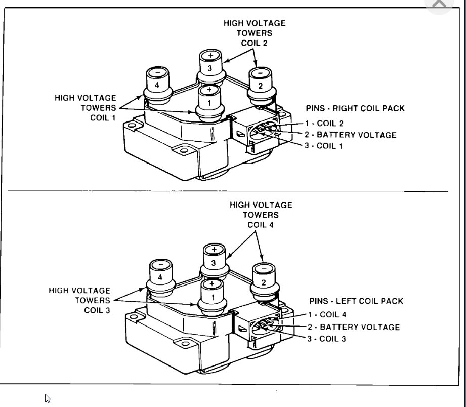

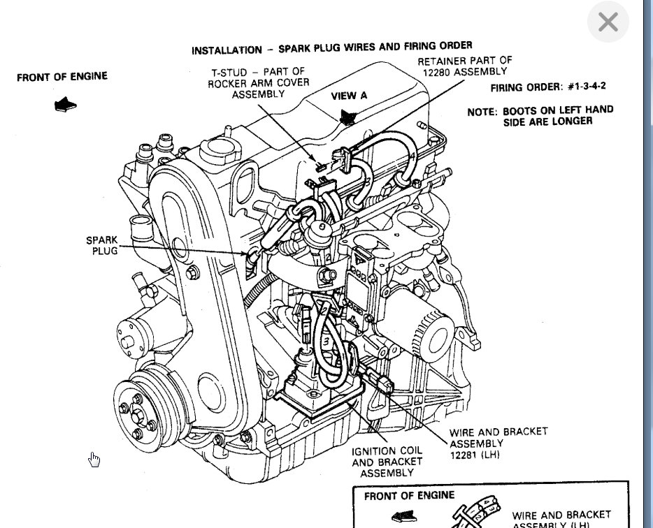

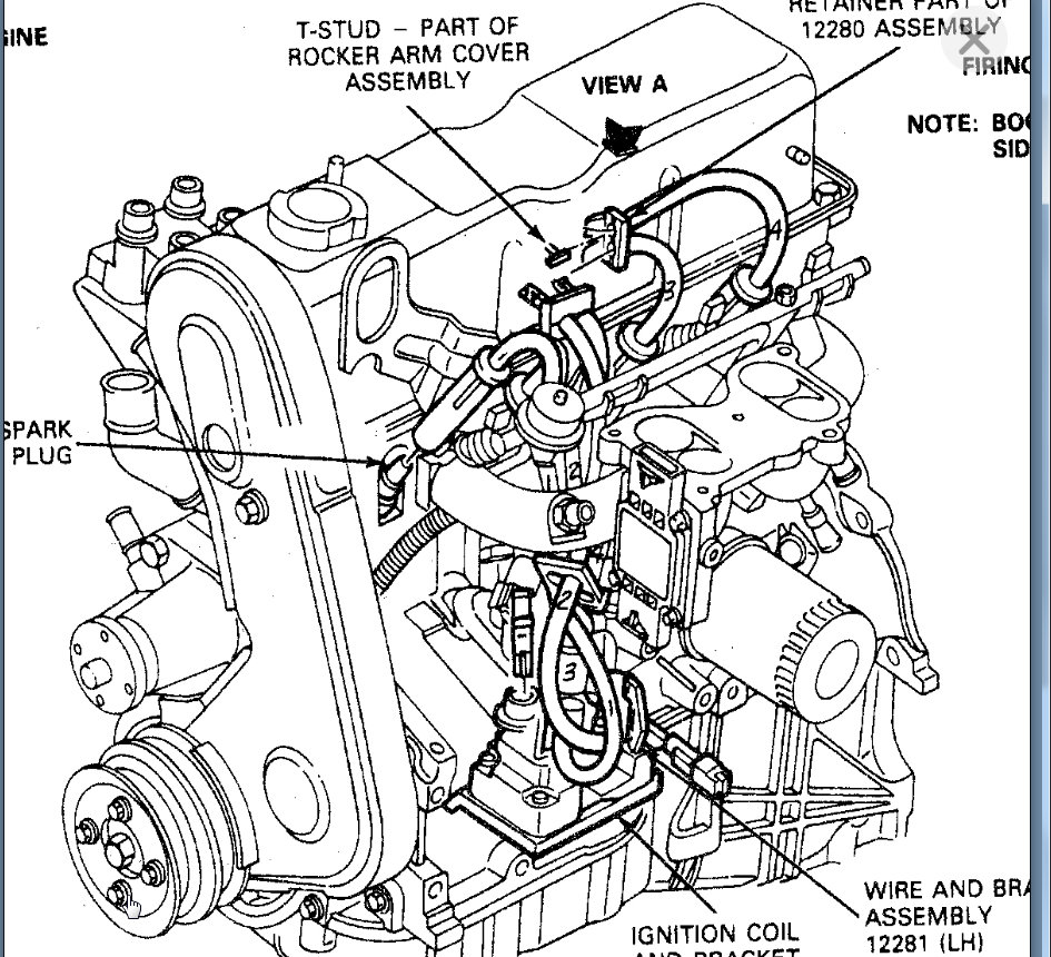

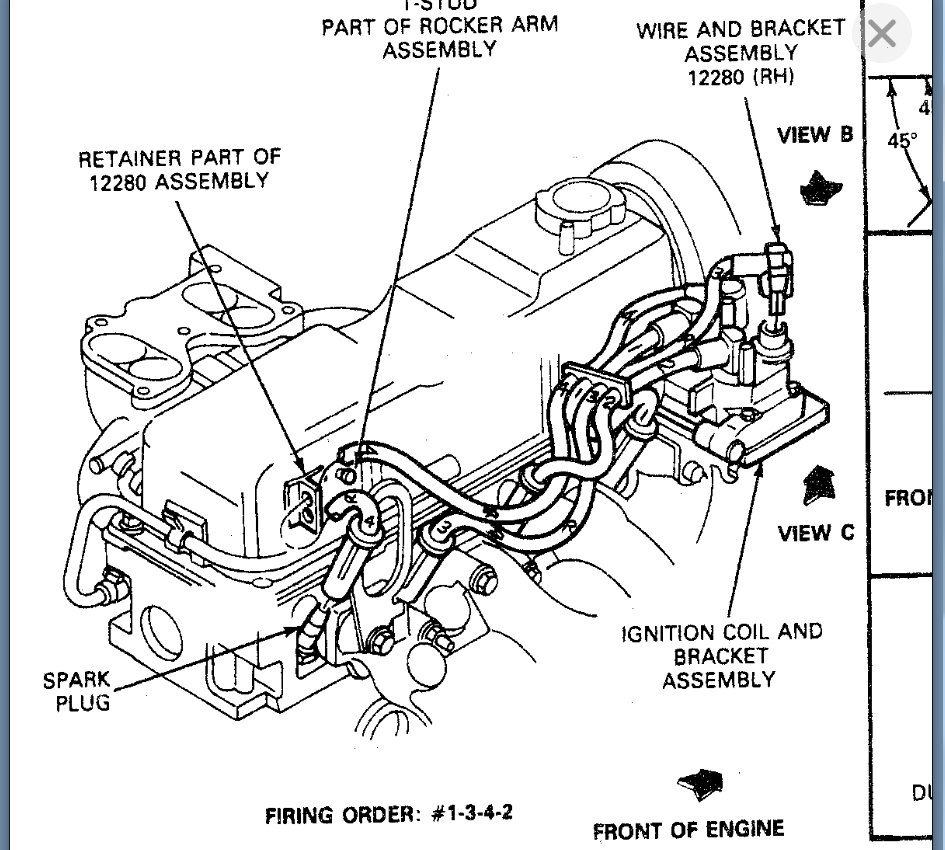

NICK LUCERO
It's got 8 plugs.
Jun 9, 2021 at 2:00 PM (Merged)

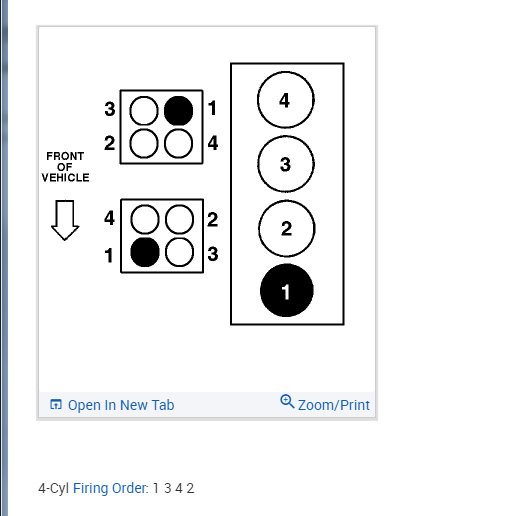

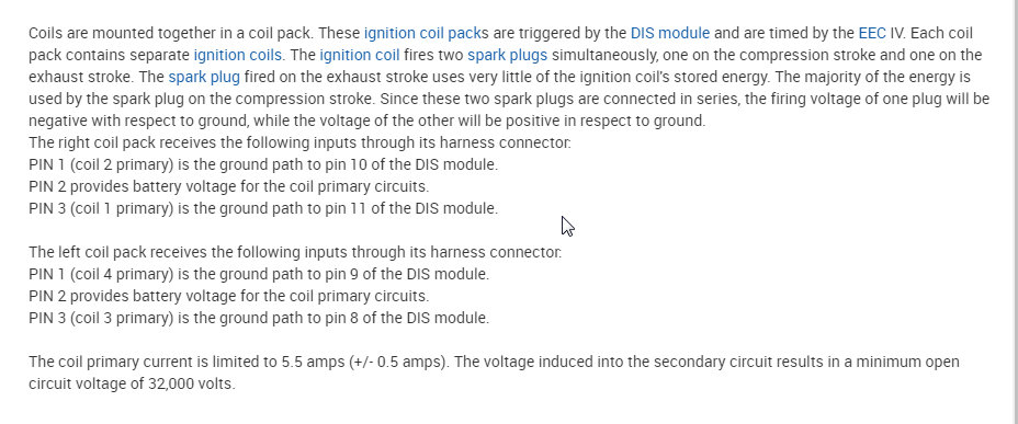

Correct. But this is a 2.3L correct? If it is then you have what is called a waste spark plug. I included a picture of both sides of the engine. You have a coil pack on both sides that has the same firing order of 1-3-4-2.
Take a look at all this info and let me know if you have questions. Thanks

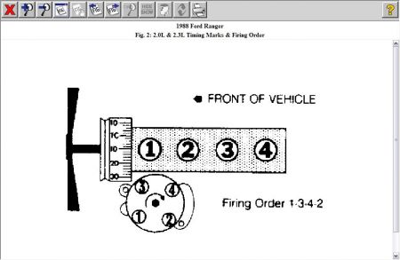

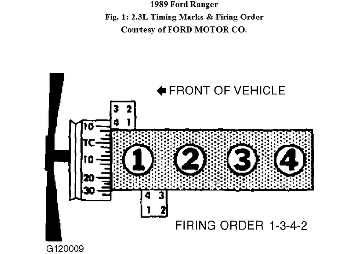

TKSTOWERS
how do I line up the marks both dots up or facing each other or what? which way does the firing order on the dist cap go counter clock or clock
  • 75,992 POSTS
See below
https://images.2carpros.com/forum/automotive_pictures/12900_firing_order_and_timing_marks_ford_ranger_88_1.jpg

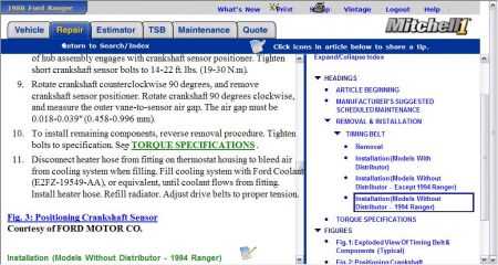

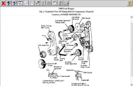

TKSTOWERS

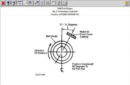

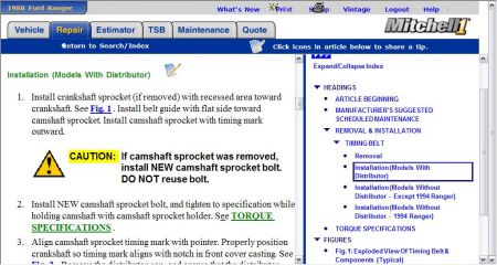

thanks that helps would you have an illustration for the timing marks? this would be helpful
  • 75,992 POSTS

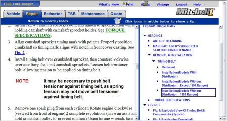

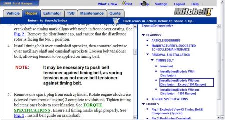

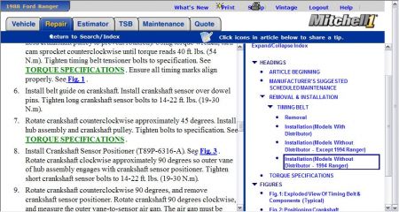

Are you talking about the sprockets alignment? If so see below
https://images.2carpros.com/forum/automotive_pictures/12900_fig1_1.jpg
https://images.2carpros.com/forum/automotive_pictures/12900_fig2_1.jpg
https://images.2carpros.com/forum/automotive_pictures/12900_dist1_1.jpg
https://images.2carpros.com/forum/automotive_pictures/12900_dist2_1.jpg
https://images.2carpros.com/forum/automotive_pictures/12900_dist4_1.jpg
https://images.2carpros.com/forum/automotive_pictures/12900_dist3_1.jpg" alt="
https://images.2carpros.com/forum/automotive_pictures/12900_dist3_1.jpg" />
https://images.2carpros.com/forum/automotive_pictures/12900_dist5_1.jpg
https://images.2carpros.com/forum/automotive_pictures/12900_dist6_1.jpg

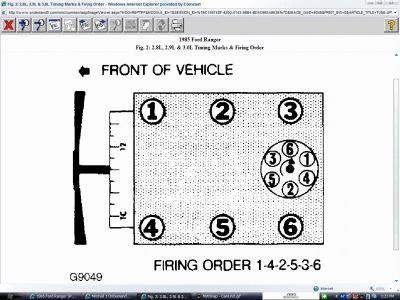

EMONEY1961
i know the firing order on block cant find firing order on distributor
BMRFIXIT
  • 19,053 POSTS
Good luck.
https://images.2carpros.com/forum/automotive_pictures/99387_ranger_firing_order_1.jpg

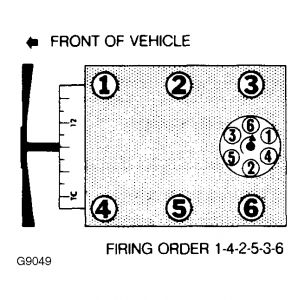

WESDURYEE
I put new distributor and wires in and and lost track of which were went where. Want a picture of firing order
JDL
  • 16,098 POSTS
https://images.2carpros.com/forum/automotive_pictures/170934_ford_ranger_firing_order_1.jpg
I have seen pictures that were not accurate.

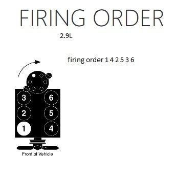

PACHYAUTO63
  • 40 POSTS
Can you show me the firing order?
JDL
  • 16,098 POSTS
This is for 2.9L engine. Hope it helps.

COLETURNER08
  • 22 POSTS
I have a 1986 Ford Ranger with a 2.3l. The block is a 1989 and the rest is a 1986. I got spark and gas. The timing is set to specks with cam and crank but it don't want to start. Could it be the computer or the cylinders.
Could the cylinders be reversed?
MERLIN2021
  • 17,250 POSTS
order is 1-3-4-2 for BOTH coil packs
MERLIN2021
  • 17,250 POSTS
cams are different on 86 and 89, what cam is in it?

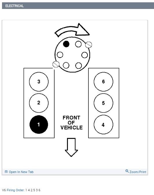

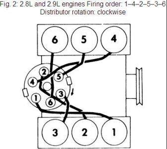

LAZYGAZER
  • 68 POSTS
What is the firing order foe a 89 ford ranger 2.9 v6
Jun 9, 2021 at 2:01 PM (Merged)
320HPPONY?
  • 24 POSTS
I have a small collection of Chiltons. I do not have one for your truck but Ford has this thing about being consistent. Do not quote me on these but I am confident this is correct. The Firing order is as follows: 1-4-2-5-3-6.
