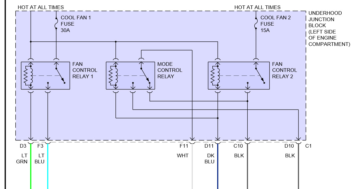

Fan is not turning on when temperature gauge get past half way point.
Wednesday, February 8th, 2017 AT 11:18 AM
HMAC300
MECHANIC
48,601 POSTS
I assume you have checked everything in the picture as well as wiring going from ECT to PCM.
Image (Click to make bigger)
