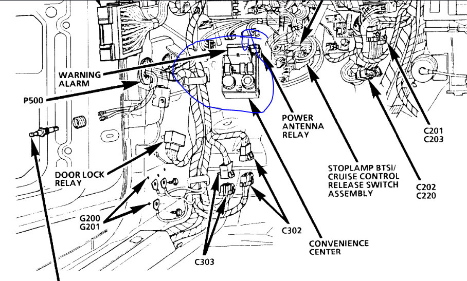

Hello people. Explain to me (beginner) what these codes mean 200, g201, p500, c303, c302, c202,220, c201, c203.

Anything with "G" will indicate a ground. "C" will indicate a connector number and the numbers after the letter will indicate it's position in the vehicle, typically 2 is either the driver or passenger side of the cabin, 3 will be behind the front seats, 4 will be in the trunk areas of the vehicle (rear). The P500 indicates a passthrough or "grommet" where the wire harness passes through the body.
