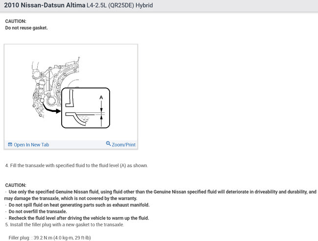

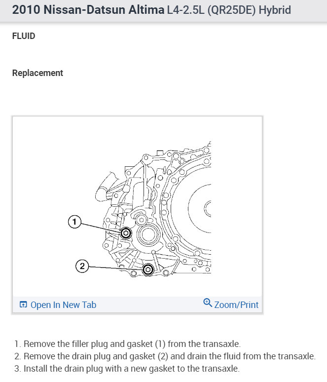

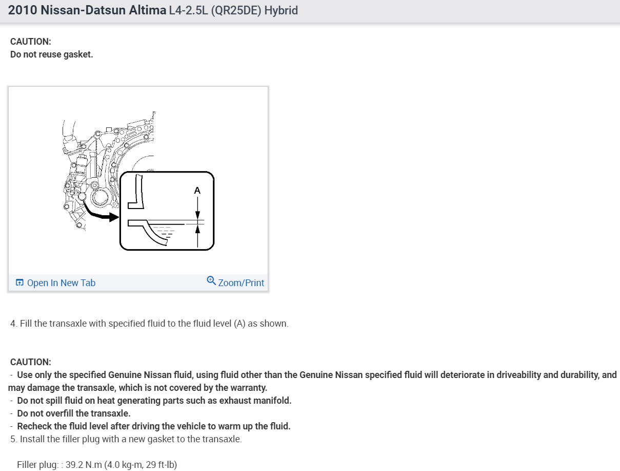

These cars had a problem with the Continuously Variable Transmission/Trans-axle. The bearings inside go bad along with the friction belt to confirm the issue lets get a fluid sample which will be (if the transmission is bad) it will smell, be a dark color, might have metallic flakes. Here is a guide on how to check the fluid level. Can you please shoot a quick video with your phone so we can hear the noise, that would be great. You can upload it here with your response so I can be sure? Can you confirm the noise location front or rear of the engine?
